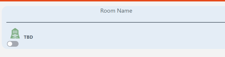

Is there a way to use a .js file with a custom widget?
I want to be able to run the .js somehow when I switch on that button written in the .yaml file. I’m aware that you can write expressions, but I want to be able to achieve that with JS and be able to pass the defined items as parameters to functions written in the .js file
I tried the JavaScript Script Binding and managed to generally import and use functions from a script written in a file locally on my device and use it in a rule directly, so is it possible to use this binding maybe with widgets?

Thank you, I managed to do something like this and seems to be working fine when I called the script:
