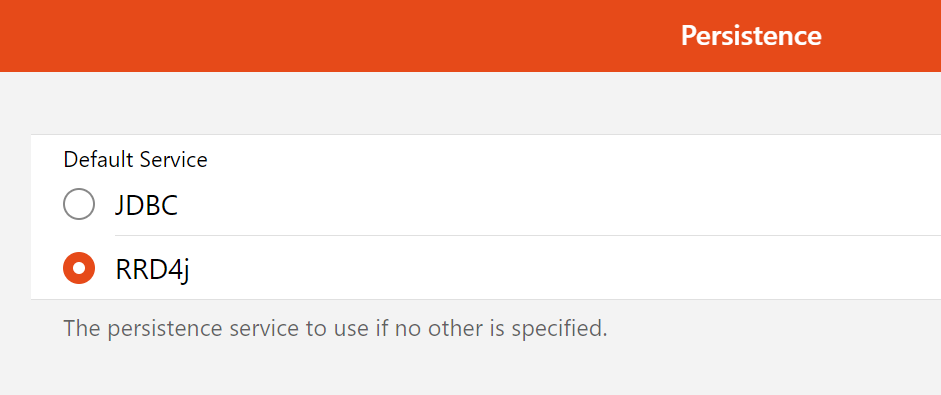

My default persistance is set to RRDJ4:

Yes, that’s the designed default behaviour at OH3.
There are pros and cons to either approach.
Either approach had good arguments to support it. I suspect that because one cannot create a .persist file through the UI and there are some non-technical users who do everything through the UI the devs choose an expansive default strategy rather than forcing non technical users to have to edit a file to get any persistence at all.
I guess it depends on whether or not you have data there that you want to keep. The easiest would be to stop OH and drop the tables. But if you need to keep some stuff you’ll have to do it item by item.
