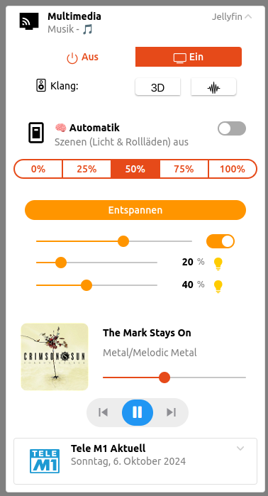

Together with a sleep tracker and the HueSyncBox Binding (work in progress) it is possible to do nice automations - e.g. if you watch a movie, listen to music - or to switch of the music on you phone if the sleep tracker reports that you’re no longer awake :slight_smile:
