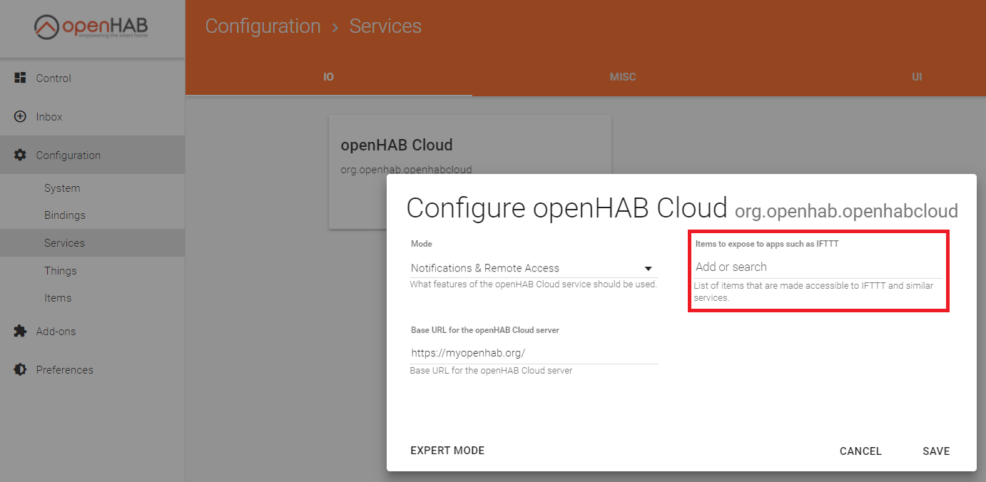

Are all of them exposed?
Note: You don’t need to expose ANY Item in the Cloud connector configuration if you simply want remote access and notifications.
Exposing Items is for integration purposes to 3rd party applications like IFTTT, Alexa, Google Assistant, etc.
Exposing Items increases the load both on your OH2 instance as well as on the myopenhab.org Cloud instance. Try to avoid it if you don’t really need this functionality
Sorry! In that case none.
I misunderstood your question.
:+1:
so: here nothing should appear:
In my case, I have 37 Items exposed (due to the Google Assistant integration that I use heavily) and I don’t see any similar Jetty warnings.
That’s correct. Nothing there.
