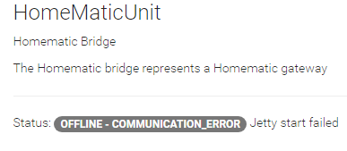

I am running OpenHab on a MiniPC with Win10 since 4 years. I updated to 2.4.0 2 weeks ago.
Since two days the HomeMatic binding is not working anymore.
When I click on the Bridge Thing, this Status appears:
OFFLINE - COMMUNICATION_ERROR Jetty start failed
