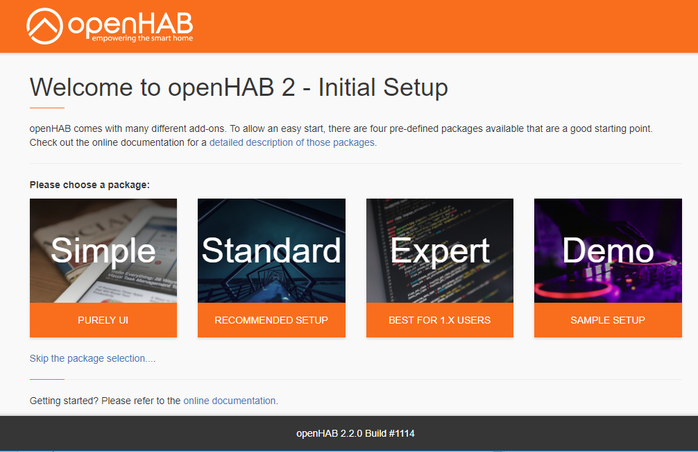

  1. Created a new virtual machine (Hyper-V)
  2. installed Ubuntu 16.04.3 Server
  3. apt update && apt dist-upgrade -y && apt autoremove -y
  4. installed mosquitto
  5. installed java:
 java version "1.8.0_151"
Java(TM) SE Runtime Environment (build 1.8.0_151-b12)
Java HotSpot(TM) 64-Bit Server VM (build 25.151-b12, mixed mode)
  1. installed openHAB 2.2.0 Build #1114. First start after installation:
openhab.log:
2017-12-06 12:21:33.092 [INFO ] [.dashboard.internal.DashboardService] - Started dashboard at http://192.168.215.195:8080
2017-12-06 12:21:33.104 [INFO ] [.dashboard.internal.DashboardService] - Started dashboard at https://192.168.215.195:8443
2017-12-06 12:21:33.776 [WARN ] [org.eclipse.jetty.http.HttpParser   ] - Illegal character 0x7F in state=HEADER_IN_VALUE for buffer DirectByteBuffer@7955e47b[p=188,l=2414,c=16384,r=2226]={HTTP/1.1 200 OK\r\n... 2017 04:21:33<<<\r\nEXT:\r\n\r\n<?xml v.../device></root>>>>\x00\x00\x00\x00\x00\x00\x00\x00\x00\x00\x00\x00\x00\x00\x00\x00\x00...\x00\x00\x00\x00\x00\x00\x00\x00\x00\x00\x00\x00\x00\x00\x00}
2017-12-06 12:21:33.780 [WARN ] [org.eclipse.jetty.http.HttpParser   ] - bad HTTP parsed: 400 Illegal character 0x7F for HttpReceiverOverHTTP@3c577535(rsp=HEADER,failure=null)[HttpParser{s=HEADER_IN_VALUE,0 of 2216}]
2017-12-06 12:21:33.971 [WARN ] [org.eclipse.jetty.http.HttpParser   ] - Illegal character 0x7F in state=HEADER_IN_VALUE for buffer DirectByteBuffer@7955e47b[p=188,l=2414,c=16384,r=2226]={HTTP/1.1 200 OK\r\n... 2017 04:21:33<<<\r\nEXT:\r\n\r\n<?xml v.../device></root>>>>\x00\x00\x00\x00\x00\x00\x00\x00\x00\x00\x00\x00\x00\x00\x00\x00\x00...\x00\x00\x00\x00\x00\x00\x00\x00\x00\x00\x00\x00\x00\x00\x00}
2017-12-06 12:21:33.971 [WARN ] [org.eclipse.jetty.http.HttpParser   ] - bad HTTP parsed: 400 Illegal character 0x7F for HttpReceiverOverHTTP@24b9bf7f(rsp=HEADER,failure=null)[HttpParser{s=HEADER_IN_VALUE,0 of 2216}]
2017-12-06 12:21:34.458 [WARN ] [org.eclipse.jetty.http.HttpParser   ] - Illegal character 0x7F in state=HEADER_IN_VALUE for buffer DirectByteBuffer@7955e47b[p=188,l=2414,c=16384,r=2226]={HTTP/1.1 200 OK\r\n... 2017 04:21:34<<<\r\nEXT:\r\n\r\n<?xml v.../device></root>>>>me>NewInternalPor...\x00\x00\x00\x00\x00\x00\x00\x00\x00\x00\x00\x00\x00\x00\x00}
2017-12-06 12:21:34.460 [WARN ] [org.eclipse.jetty.http.HttpParser   ] - bad HTTP parsed: 400 Illegal character 0x7F for HttpReceiverOverHTTP@4085cb93(rsp=HEADER,failure=null)[HttpParser{s=HEADER_IN_VALUE,0 of 2216}]
2017-12-06 12:21:34.957 [WARN ] [org.eclipse.jetty.http.HttpParser   ] - Illegal character 0x7F in state=HEADER_IN_VALUE for buffer DirectByteBuffer@7955e47b[p=188,l=2414,c=16384,r=2226]={HTTP/1.1 200 OK\r\n... 2017 04:21:34<<<\r\nEXT:\r\n\r\n<?xml v.../device></root>>>>tedStateVariable>...\x00\x00\x00\x00\x00\x00\x00\x00\x00\x00\x00\x00\x00\x00\x00}
2017-12-06 12:21:34.958 [WARN ] [org.eclipse.jetty.http.HttpParser   ] - bad HTTP parsed: 400 Illegal character 0x7F for HttpReceiverOverHTTP@178813ef(rsp=HEADER,failure=null)[HttpParser{s=HEADER_IN_VALUE,0 of 2216}]
2017-12-06 12:21:35.460 [WARN ] [org.eclipse.jetty.http.HttpParser   ] - Illegal character 0x7F in state=HEADER_IN_VALUE for buffer DirectByteBuffer@7955e47b[p=188,l=2414,c=16384,r=2226]={HTTP/1.1 200 OK\r\n... 2017 04:21:35<<<\r\nEXT:\r\n\r\n<?xml v.../device></root>>>>tedStateVariable>...\x00\x00\x00\x00\x00\x00\x00\x00\x00\x00\x00\x00\x00\x00\x00}
2017-12-06 12:21:35.461 [WARN ] [org.eclipse.jetty.http.HttpParser   ] - bad HTTP parsed: 400 Illegal character 0x7F for HttpReceiverOverHTTP@3cdb185d(rsp=HEADER,failure=null)[HttpParser{s=HEADER_IN_VALUE,0 of 2216}]
2017-12-06 12:21:36.505 [INFO ] [thome.model.lsp.internal.ModelServer] - Started Language Server Protocol (LSP) service on port 5007
2017-12-06 12:26:19.397 [WARN ] [org.eclipse.jetty.http.HttpParser   ] - Illegal character 0x7F in state=HEADER_IN_VALUE for buffer DirectByteBuffer@7955e47b[p=188,l=2414,c=16384,r=2226]={HTTP/1.1 200 OK\r\n... 2017 04:26:19<<<\r\nEXT:\r\n\r\n<?xml v.../device></root>>>>tedStateVariable>...\x00\x00\x00\x00\x00\x00\x00\x00\x00\x00\x00\x00\x00\x00\x00}
2017-12-06 12:26:19.400 [WARN ] [org.eclipse.jetty.http.HttpParser   ] - bad HTTP parsed: 400 Illegal character 0x7F for HttpReceiverOverHTTP@13fc279e(rsp=HEADER,failure=null)[HttpParser{s=HEADER_IN_VALUE,0 of 2216}]
2017-12-06 12:26:19.496 [WARN ] [org.eclipse.jetty.http.HttpParser   ] - Illegal character 0x7F in state=HEADER_IN_VALUE for buffer DirectByteBuffer@7955e47b[p=188,l=2414,c=16384,r=2226]={HTTP/1.1 200 OK\r\n... 2017 04:26:19<<<\r\nEXT:\r\n\r\n<?xml v.../device></root>>>>tedStateVariable>...\x00\x00\x00\x00\x00\x00\x00\x00\x00\x00\x00\x00\x00\x00\x00}
2017-12-06 12:26:19.498 [WARN ] [org.eclipse.jetty.http.HttpParser   ] - bad HTTP parsed: 400 Illegal character 0x7F for HttpReceiverOverHTTP@141a18d4(rsp=HEADER,failure=null)[HttpParser{s=HEADER_IN_VALUE,0 of 2216}]
2017-12-06 12:41:14.400 [WARN ] [org.eclipse.jetty.http.HttpParser   ] - Illegal character 0x7F in state=HEADER_IN_VALUE for buffer DirectByteBuffer@7955e47b[p=188,l=2414,c=16384,r=2226]={HTTP/1.1 200 OK\r\n... 2017 04:41:14<<<\r\nEXT:\r\n\r\n<?xml v.../device></root>>>>tedStateVariable>...\x00\x00\x00\x00\x00\x00\x00\x00\x00\x00\x00\x00\x00\x00\x00}
2017-12-06 12:41:14.409 [WARN ] [org.eclipse.jetty.http.HttpParser   ] - bad HTTP parsed: 400 Illegal character 0x7F for HttpReceiverOverHTTP@4daf5f5f(rsp=HEADER,failure=null)[HttpParser{s=HEADER_IN_VALUE,0 of 2216}]
2017-12-06 12:56:09.413 [WARN ] [org.eclipse.jetty.http.HttpParser   ] - Illegal character 0x7F in state=HEADER_IN_VALUE for buffer DirectByteBuffer@7955e47b[p=188,l=2414,c=16384,r=2226]={HTTP/1.1 200 OK\r\n... 2017 04:56:09<<<\r\nEXT:\r\n\r\n<?xml v.../device></root>>>>tedStateVariable>...\x00\x00\x00\x00\x00\x00\x00\x00\x00\x00\x00\x00\x00\x00\x00}
2017-12-06 12:56:09.418 [WARN ] [org.eclipse.jetty.http.HttpParser   ] - bad HTTP parsed: 400 Illegal character 0x7F for HttpReceiverOverHTTP@2ae98ed3(rsp=HEADER,failure=null)[HttpParser{s=HEADER_IN_VALUE,0 of 2216}]
2017-12-06 12:56:09.426 [WARN ] [org.eclipse.jetty.http.HttpParser   ] - Illegal character 0x7F in state=HEADER_IN_VALUE for buffer DirectByteBuffer@7955e47b[p=188,l=2414,c=16384,r=2226]={HTTP/1.1 200 OK\r\n... 2017 04:56:09<<<\r\nEXT:\r\n\r\n<?xml v.../device></root>>>>tedStateVariable>...\x00\x00\x00\x00\x00\x00\x00\x00\x00\x00\x00\x00\x00\x00\x00}
2017-12-06 12:56:09.427 [WARN ] [org.eclipse.jetty.http.HttpParser   ] - bad HTTP parsed: 400 Illegal character 0x7F for HttpReceiverOverHTTP@52da42d(rsp=HEADER,failure=null)[HttpParser{s=HEADER_IN_VALUE,0 of 2216}]
2017-12-06 13:11:04.406 [WARN ] [org.eclipse.jetty.http.HttpParser   ] - Illegal character 0x7F in state=HEADER_IN_VALUE for buffer DirectByteBuffer@7955e47b[p=188,l=2414,c=16384,r=2226]={HTTP/1.1 200 OK\r\n... 2017 05:11:04<<<\r\nEXT:\r\n\r\n<?xml v.../device></root>>>>tedStateVariable>...\x00\x00\x00\x00\x00\x00\x00\x00\x00\x00\x00\x00\x00\x00\x00}
2017-12-06 13:11:04.408 [WARN ] [org.eclipse.jetty.http.HttpParser   ] - bad HTTP parsed: 400 Illegal character 0x7F for HttpReceiverOverHTTP@6aa559fe(rsp=HEADER,failure=null)[HttpParser{s=HEADER_IN_VALUE,0 of 2216}]
