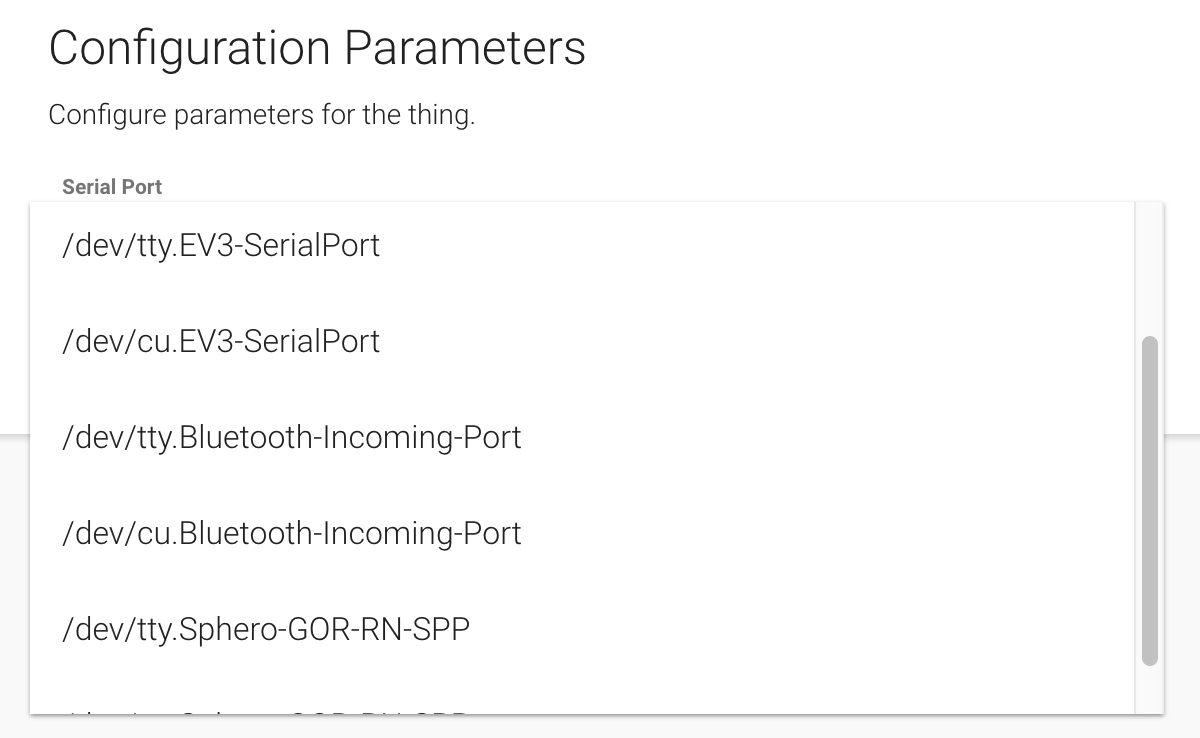

  • Another small, but imho very useful new feature is the drop-down support for serial port selection in configurations. Instead of figuring out, which port names are available in your system, they can now be nicely presented to you:
    Bindings that use serial ports have to be adapted (developers: simply adding serial-port as a context to their configuration parameter in the XML is all it takes!). I have done so for a few already, but Z-Wave and Zigbee are e.g. not yet covered, so do not wonder why you don’t see this there yet.
