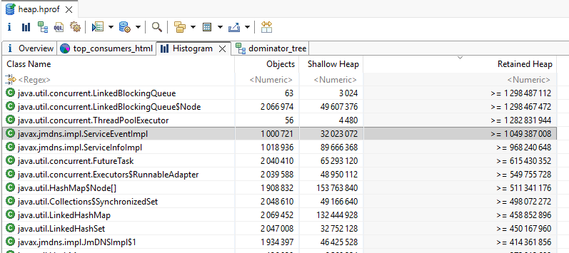

What i can see is that the java process grow to 4Gb, and at some point, the web interface does not response anymore. At this point, even the ssh connection to karaf console go down.
Yesterday, I make a memory dump and jstack on the instance before it completly lock down.
What i find is many reference java.jmdns.impl.ServiceEventImpl (see the capture below).

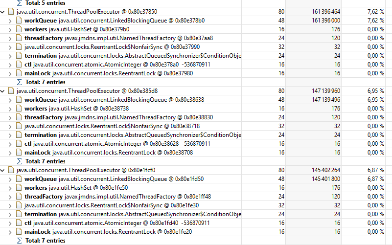

If i look to the dominator tree, I see several ThreadPoolExecutor, with jmdns related stuff inside.
I don’t know how to futher check this issue.

I found 21 deadlocks in your thread dump in total, and while that is a lot, it doesn’t explain why you run out of memory. I found 424 threads in all, which isn’t that high, and should only consume some… 400 MB of memory. But, what probably happens is that these threads starve some of the thread pools so that these thread pools stop performing tasks, making the queues grow indefinitely.
Those queues, in the end, will consume all available memory. Thus, exactly which objects that exist in the highest numbers might not be that important, they probably exist because they are stuck in a non-moving queue. This probably isn’t technically a memory leak (which is very difficult to achieve in Java), but the effect is much the same.
