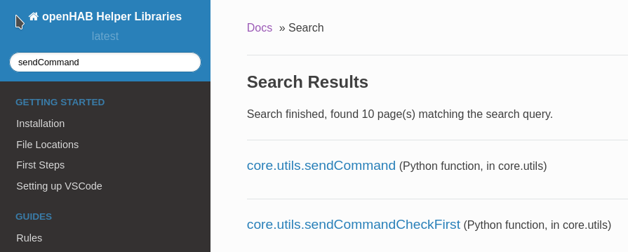

Here is something else that is easy to miss… the helper library docs have a search tool at the top left…
core.utils.sendCommand was grandfathered in when lucid was migrated back into the main repo to maintain backwards compatibility for people that had been using lucid. I think it has caused more trouble than it solved. Just use events.sendCommand.
:+1: that was what I was looking for and yes I, too, missed that until now.
