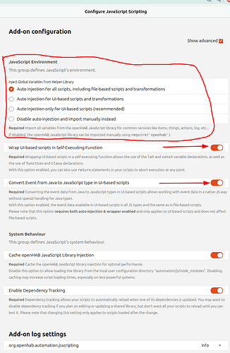

Both of these are separately enabled or disabled in addition to enabling automatic injection of the helper library variables (e.g. actions) in the add-on settings. Here is what the new settings looks like.

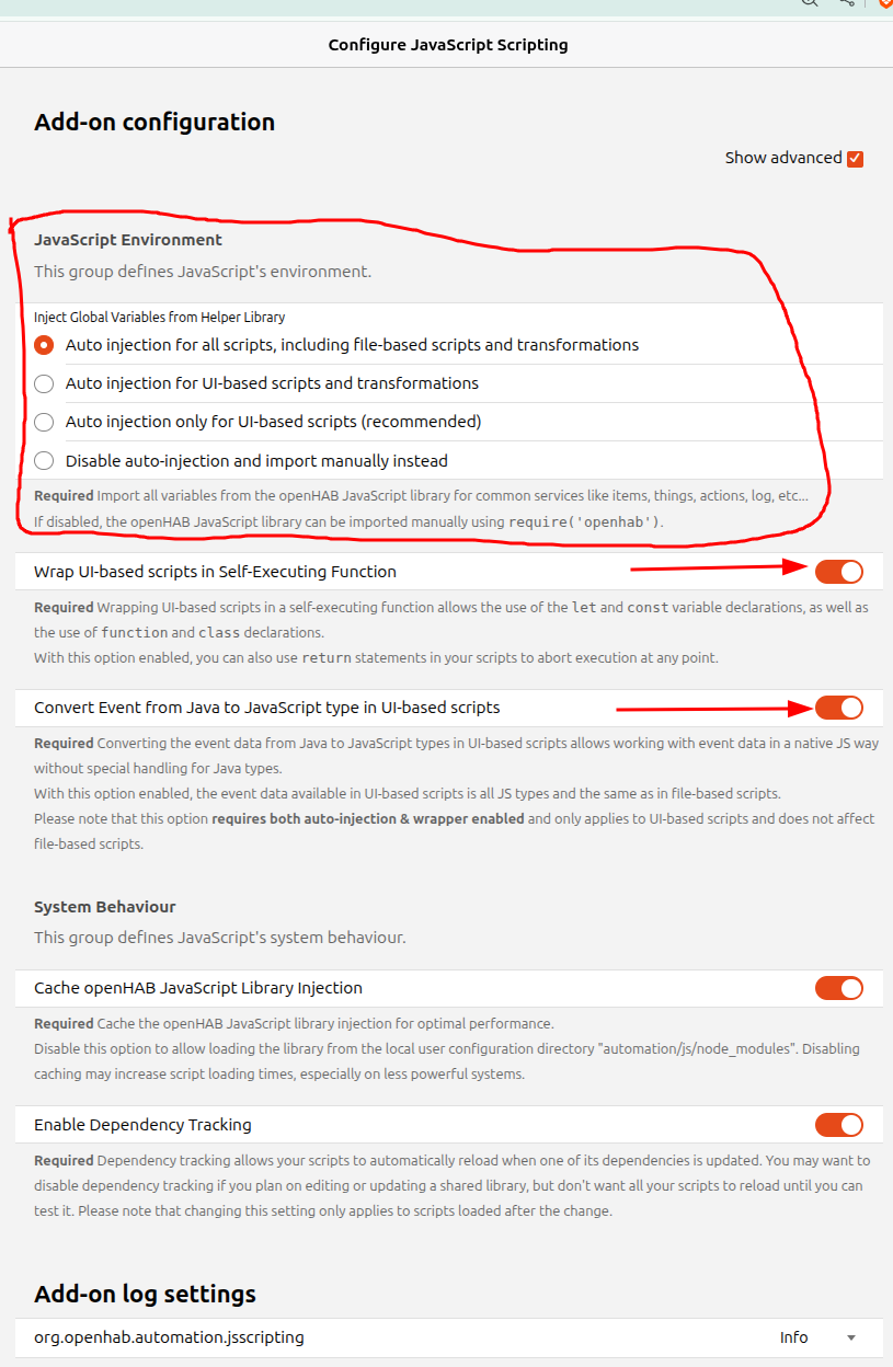

Now when I upgraded to OH 5.1 M1 this didn’t go super smoothly. I was seeing errors similar to what you report indicating that the helper library variables were not being injected for some rules. What I did was toggle “Auto injection for UI-based scripts and transformations”, save and restart OH. Sometime later I toggled it back to first option. That seemed to fix it but I don’t know for sure if that was a fluke or not nor am I absolutely certain what I saw was an error (yours is only the second after my experience that seems similar).
But in short, if any of the first three injection options is selected, actions should be there without importing it with a require.
When “Wrap UI-based scripts in Self-Executing Function” is enabled, you can use let, const and most importantly return in your scripts (note changes in OH 5.1 M2 should enable the wrapper for all JS Script Conditions and this toggle will only impact JS Script Actions.
When “Convert Event from Java to JavaScript type in UI-based scripts” is enabled, instead of the raw Java event Object with all the pain that is (a Java String is not a JS String), the same JS event Object file based JS users have enjoyed all this time will be used. The old property names are still there, but a deprecation warning will be shown in the logs. See JavaScript Scripting - Automation | openHAB for details.

Based on the ALERT on line 182 in the 5.1M1 release, when it didn’t work initially I switched to the second options on the JS Scripting options page, Auto injection for UI …
