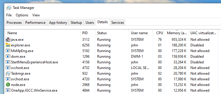

I’ve also been experiencing this issue since upgrading to 3.4.0.M5 on my Windows box. See log below. I had a previous version of JDK (I think it was 11.0.09) when the problem first occurred. I updated my Java to 11.0.17 but that doesn’t seem to have fixed the problem. I read on Github that this issue is believed to be related to armv7l and OpenJDK 11.0.16, so I’m posting my experience here since I’m using 11.0.17. It happens only intermittently.
Intel(R) Celeron(R) CPU N3450 @ 1.10GHz 1.10 GHz
8.00 GB (7.79 GB usable)
Windows 10 Pro
openjdk version ā€œ11.0.17ā€ 2022-10-18 LTS
OpenJDK Runtime Environment Zulu11.60+19-CA (build 11.0.17+8-LTS)
OpenJDK 64-Bit Server VM Zulu11.60+19-CA (build 11.0.17+8-LTS, mixed mode)
OpenHAB 3.4.0.M5

2022-12-21 23:59:08.313 [ERROR] [internal.handler.ScriptActionHandler] - Script execution of rule with UID 'Goodnight' failed: org.graalvm.polyglot.PolyglotException: ReferenceError: "rules" is not defined
This occurred when I used rules.runRule in my ā€œGoodnightā€ rule.
configuration: {}
triggers:
  - id: "1"
    configuration:
      time: 23:59
    type: timer.TimeOfDayTrigger
conditions: []
actions:
  - inputs: {}
    configuration:
      considerConditions: false
      ruleUIDs:
        - AllLightsOff
    type: core.RunRuleAction
  - inputs: {}
    configuration:
      type: application/javascript;version=ECMAScript-2021
      script: |-
        rules.runRule("LockDoor", {'door': 'Back'});
        rules.runRule("LockDoor", {'door': 'Front'});
    type: script.ScriptAction```
Perhaps not unrelatedly, my Windows box is often very sluggish in responding since I have upgraded to 3.4.0.M5. It used to be quite snappy. I haven’t fully diagnosed why, but I have noticed that Java seems to be sporadically using a monster amount of CPU and memory, which seems like a likely culprit. This morning, after the error occurring at midnight before, it was quite sluggish:
