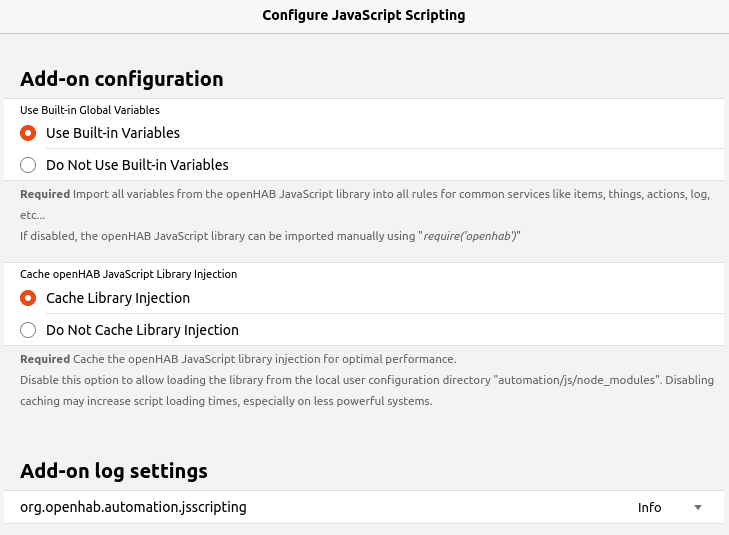

Did you disable caching in the add-on settings?
Yes…I did several restarts… delete tmp and cache folders …
My simple idea is that the rest of openhab-core is not yet ready?
That is not the same thing.
The JSScripting add-on comes with a built-in version of the library and it will use that by default. If you want to use a version of the library other than the built-in one (for example that you installed via npm) then you have to go to the add-on settings for JSscripting and explicitly disable the setting that caches the built-in library so that your custom library gets injected into the rule contexts instead.

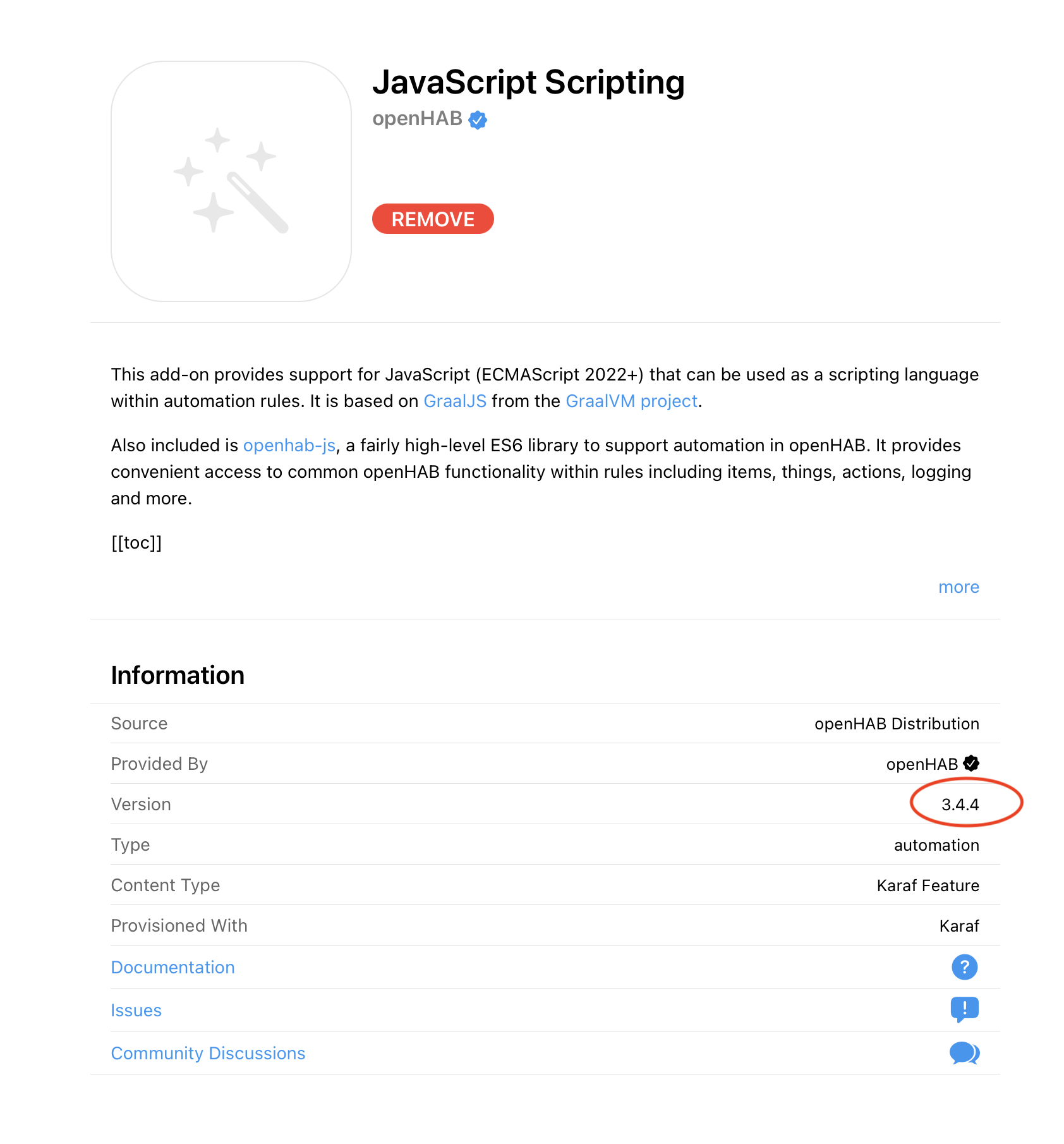

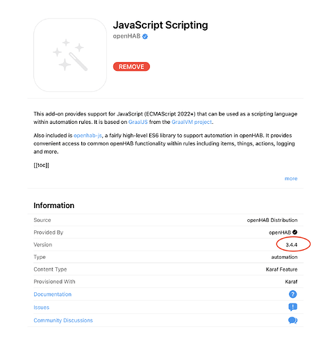

Does this tell you anything?
Scripting version 3.4.4
bash-3.2$ find . -name “*.jar”|grep script
./runtime/system/org/openhab/core/bundles/org.openhab.core.automation.module.script.rulesupport/3.4.4/org.openhab.core.automation.module.script.rulesupport-3.4.4.jar
./runtime/system/org/openhab/core/bundles/org.openhab.core.model.script/3.4.4/org.openhab.core.model.script-3.4.4.jar
./runtime/system/org/openhab/core/bundles/org.openhab.core.automation.module.script/3.4.4/org.openhab.core.automation.module.script-3.4.4.jar
./runtime/system/org/openhab/core/bundles/org.openhab.core.model.script.ide/3.4.4/org.openhab.core.model.script.ide-3.4.4.jar
./runtime/system/org/openhab/core/bundles/org.openhab.core.model.script.runtime/3.4.4/org.openhab.core.model.script.runtime-3.4.4.jar
./userdata/tmp/mvn/org/openhab/addons/bundles/org.openhab.automation.jsscripting/3.4.4/org.openhab.automation.jsscripting-3.4.4.jar
No, that’s the version of the add-on and it will always match the version of OH core. The versioning of openhab-js is independent of that.
