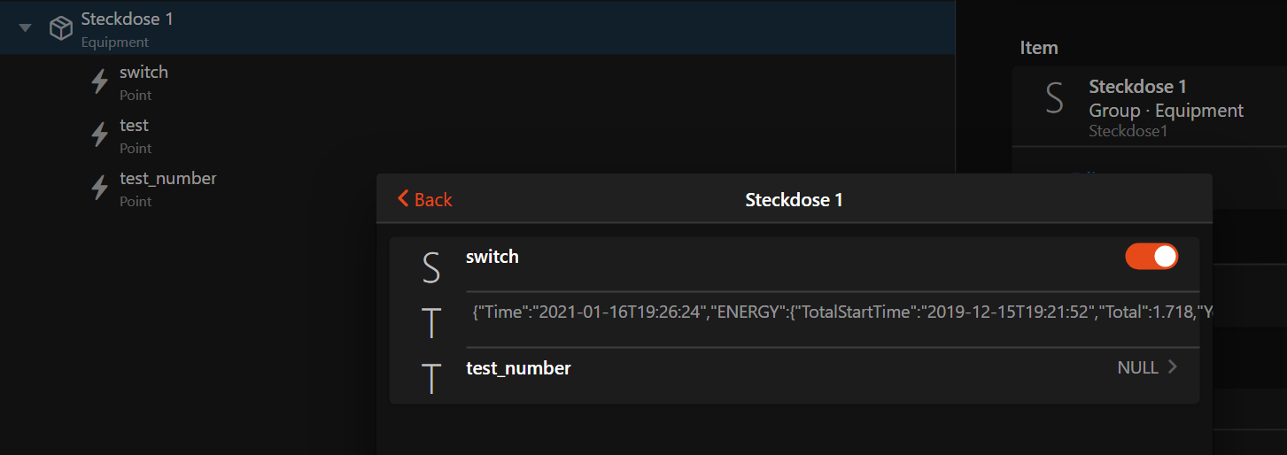

I just cannot manage to read any numbers for power consumption etc from my tasmota flashed power plug.
I get a read from MQTT by this stat query:
tele/Steckdose1/SENSOR
{“Time”:“2021-01-16T19:06:24”,“ENERGY”:{“TotalStartTime”:“2019-12-15T19:21:52”,“Total”:1.710,“Yesterday”:0.000,“Today”:0.032,“Period”:2,“Power”:24,“ApparentPower”:36,“ReactivePower”:27,“Factor”:0.66,“Voltage”:234,“Current”:0.153}}
I can read this from OH3 as a string (the 2nd point/item)

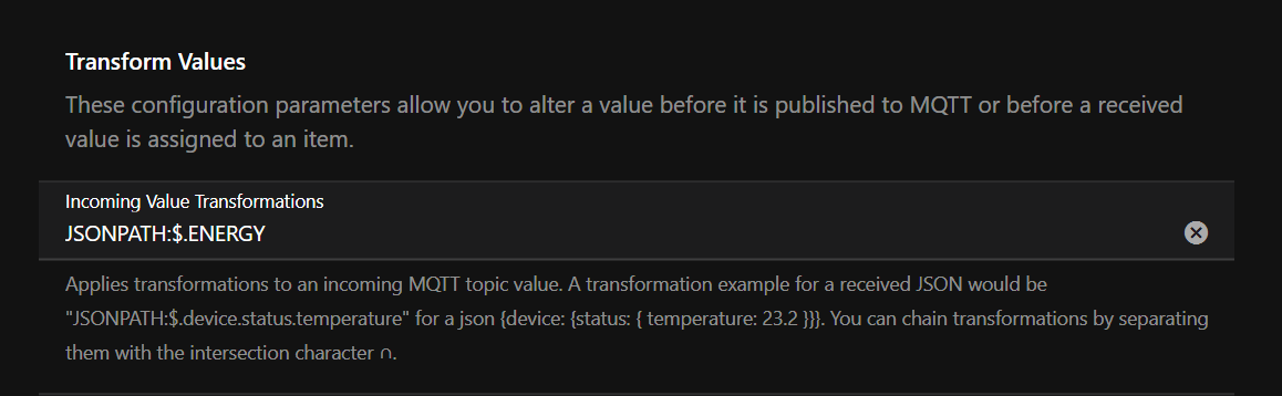

if I add this “JSONPATH:$.ENERGY.Power” to the configuration of the channel, nothing happens
- I get a “NULL” if I define the Channel as number (3rd point)
- I get the whole string (nothing/everything parsed) if I define it as a string (not shown)
