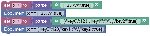

Parse
firefox_s7SsQ9VKrO
Takes a proper JSON string and converts to a complex object.
Returns: List|Dictionary
Usage

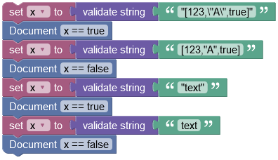

Validate String
firefox_ylbWFjy5BU
Validates a JSON string or string against the JSON parser to determine if valid.
Returns: true|false
Usage

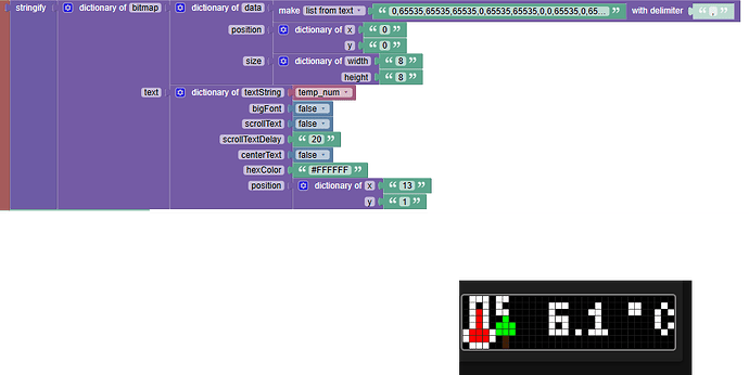

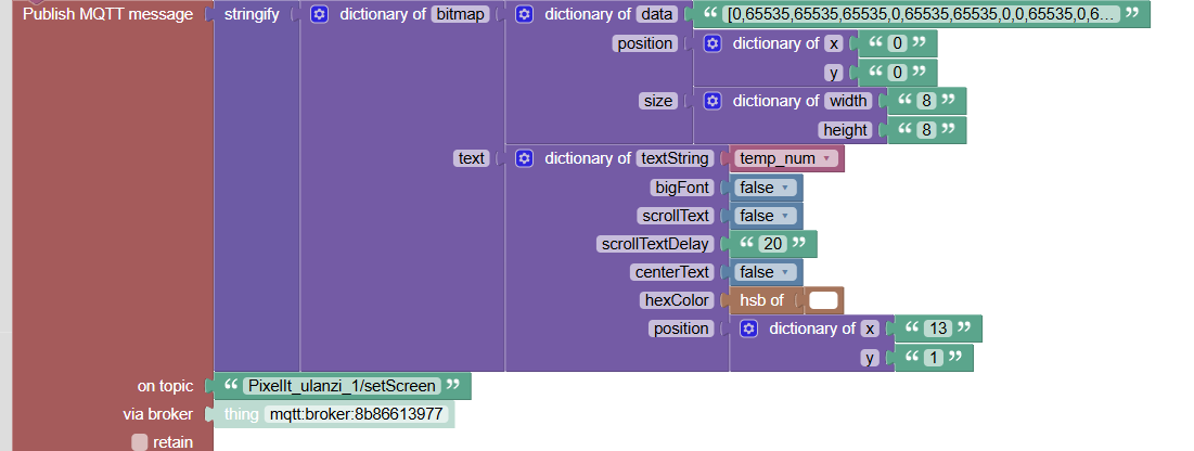

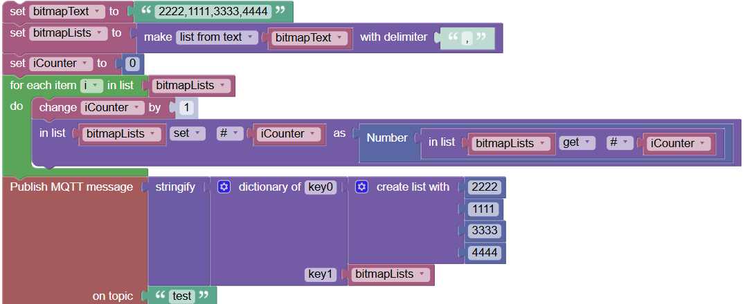

I wanted to use json tools under Blockly to control a pixel clock via MQTT, but I can’t send bitmaps to it. How do I construct the JSON string so that the array is not treated as text?
Thanks,
KZ

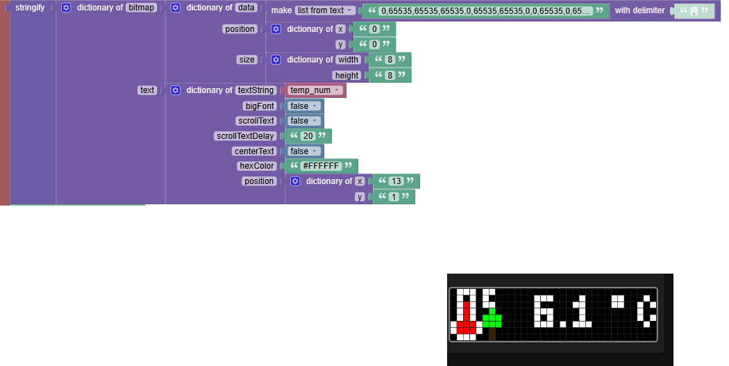

You can pass the values as an array (key0) or convert the text without brackets value by value into a number (key1)
Thank you very much for guiding me to the solution:
the “make list from text” command is sufficient.
I still need to test it with animated bitmaps.
