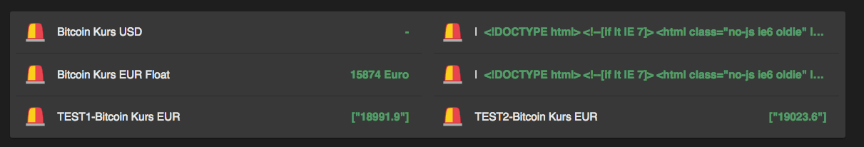

Thanks rich, i was testing a lot of JSONPATH constellations (trial & error) in the group item but without success…
i did try your guess too, no luck - so i decided to go with different rules - this works as expected
just one little thing, i get a string out of my rule and want to have it as DecimalType for rounding - could you help here ?
i found your post in another thread about String:format, but dont get it to work correctly…
Thanks!

EDIT:
i found a solution for a Number Item finally
rule "BITCON EUR (coinmarketcap) Test"
Time cron "0 * * * * ?"
var String json = sendHttpGetRequest("https://api.coinmarketcap.com/v1/ticker/bitcoin/?convert=EUR")
var String value = transform("JSONPATH", "$.[0].price_eur", json)
value = String::format("%.0f", Float.parseFloat(value))
logInfo("JSON RULE","******BITCOIN-TEST*******: " + value )
Bitcoin_EUR_JSON_Test.postUpdate(Float::parseFloat(String::format("%s",value)))
