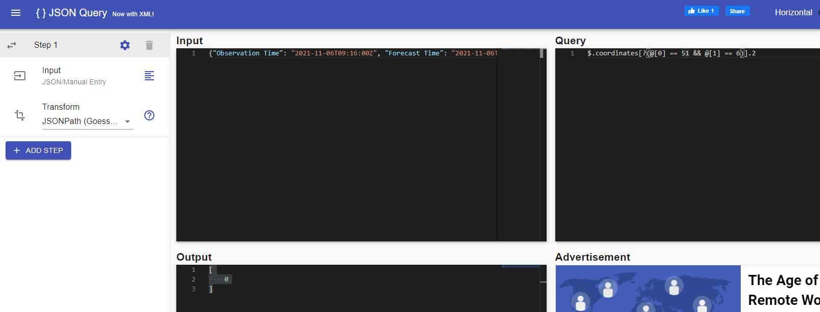

I successfully tested the JSONPATH at Online JSON Query Tester (jsonquerytool.com) using the Goessner 0.8.0 transform and it succeeded:
