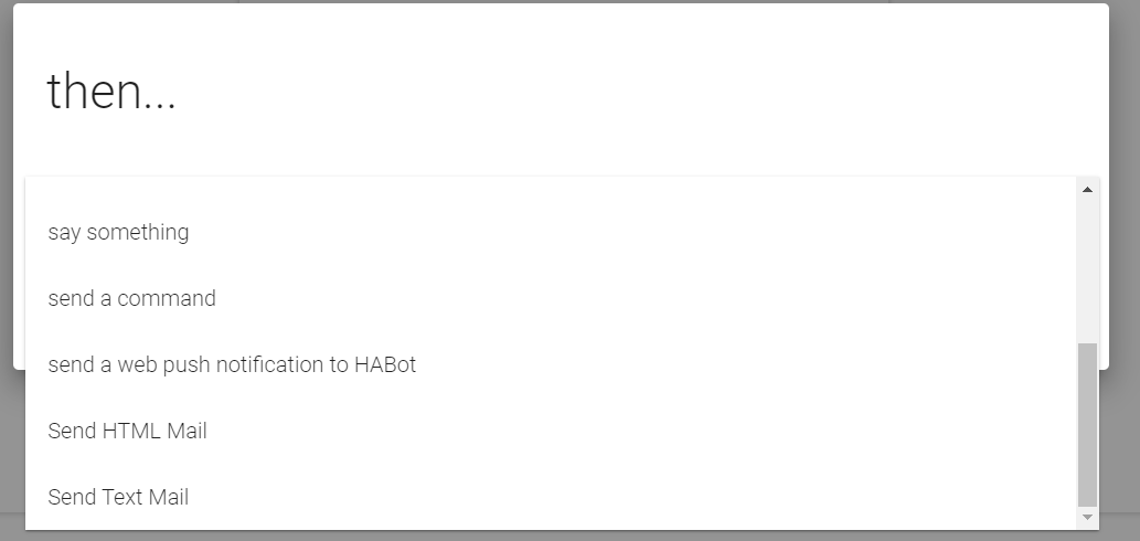

PS: stumbling across this and browsing the docs as a normal user, I came across several binding docs pages with examples. But they’re all in rules DSL.
I think we would need to complement all of them with Python equivalent ? (JS or Groovy I think is not so important as it isn’t all too much used)

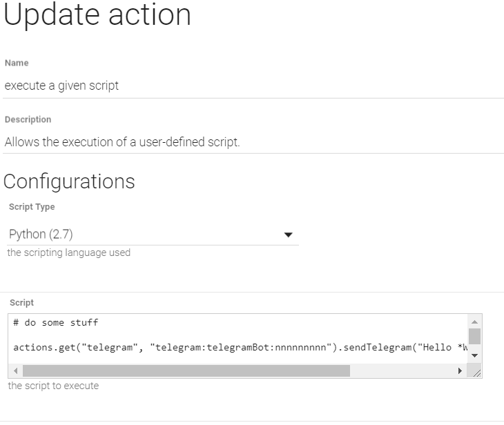

So, for example, if I create a Rule in PaperUI right now with a custom Script that needs to do some stuff and then send a Telegram using the Telegram 2.x binding’s Action it would look like:
The contents of the Script is:
# do some stuff
actions.get("telegram", "telegram:telegramBot:nnnnnnnnn").sendTelegram("Hello *World* " +  u"\U0001F44D")
# do some more stuff
Notice it’s pretty much exactly like Marcus’ example above. How someone would use these Actions from inside a Script is unlikely to change much if at all. So unless @5iver knows something I don’t, it’s likely safe to add examples to the bindings that use Actions.
