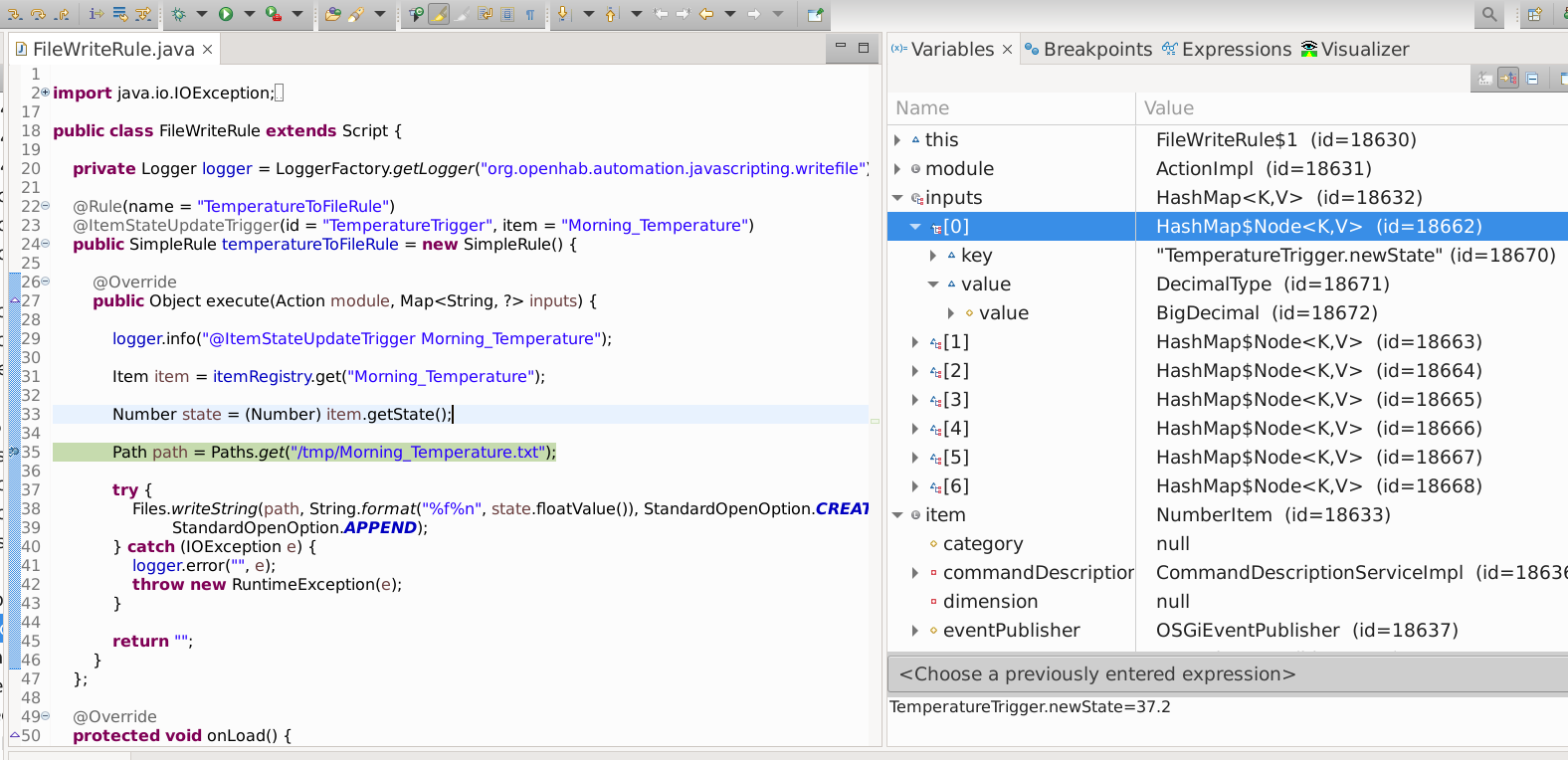

Java Scripting for openHAB gives the power of Java and a Java IDE to openHAB script development and debugging.
