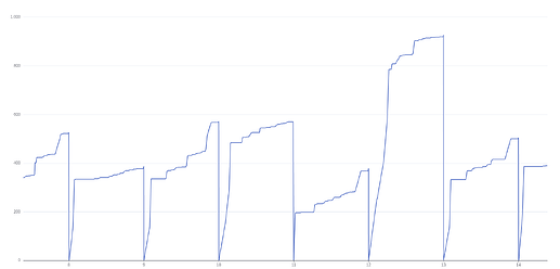

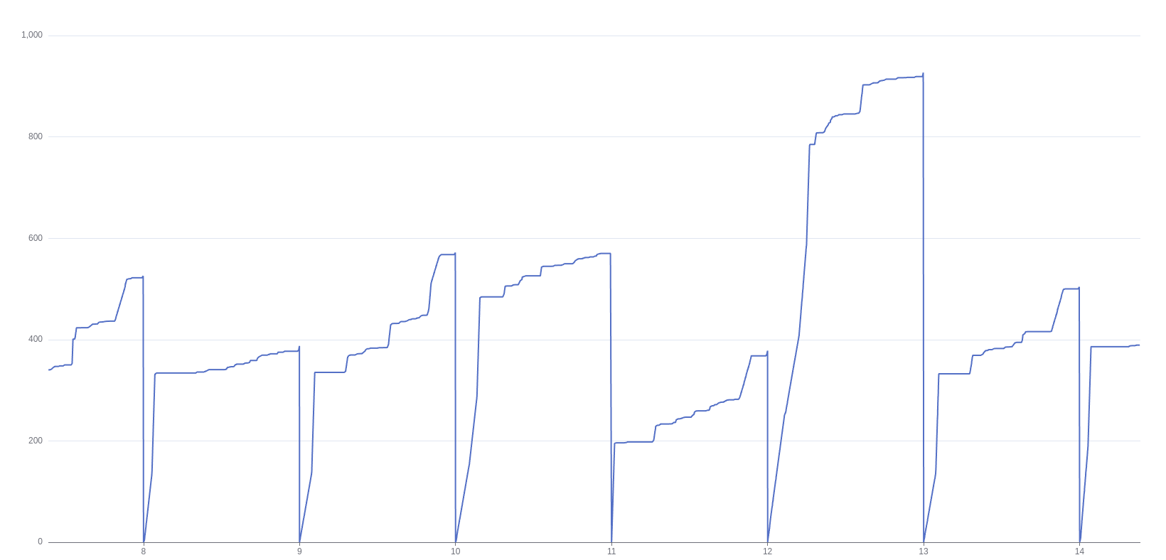

The item in question exists and has plenty of persisted data:
