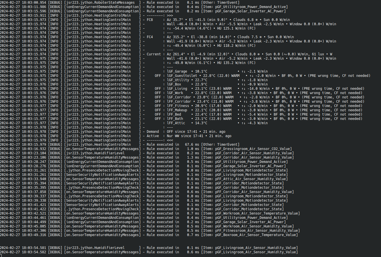

And this is the way how my rules look like, using my own helper libs
https://github.com/HolgerHees/openhab-config/tree/master/conf/automation/jsr223
you can enable profiling by an additional annotation, it measures the performance and it shows you always source events. The decorator for that you can find here.
