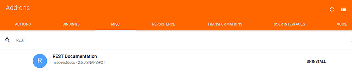

Install the add-on / Misc / REST docs

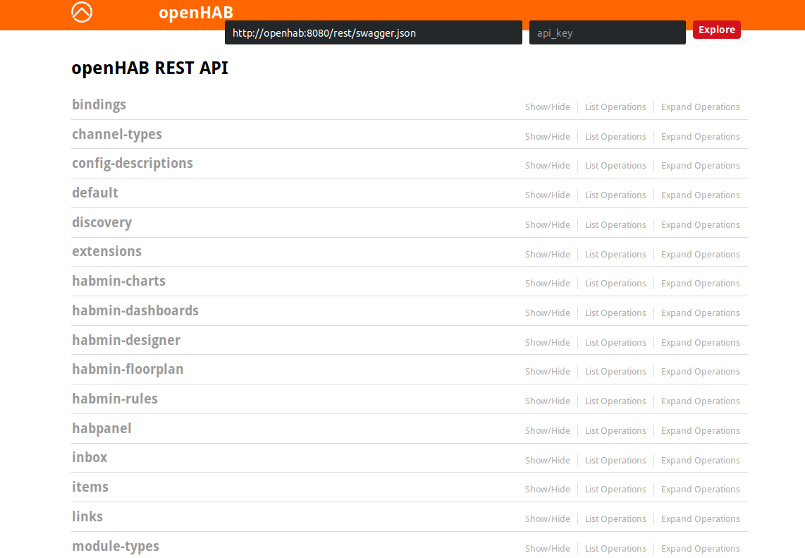

The REST API should appear in your dashboard:

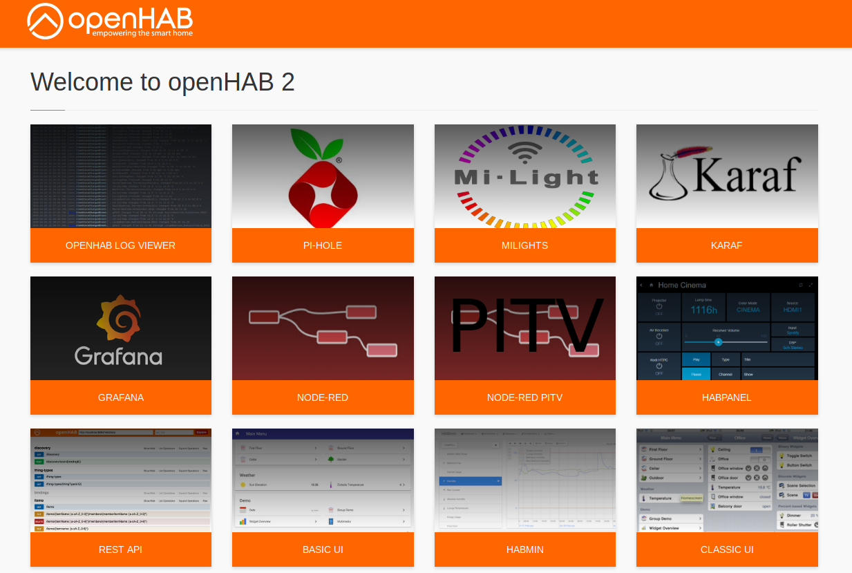

What is this blackmagic you’re playing with and have other tiles li pi hole?

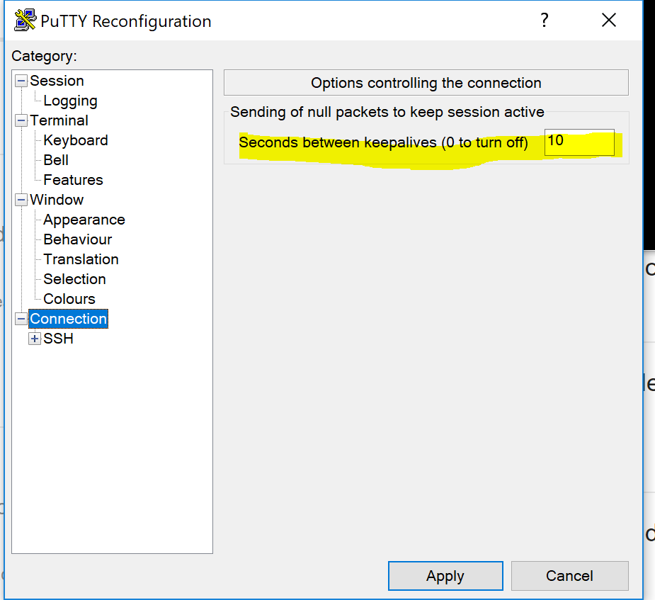

I found a setting in putty which helps with the idle timeout issue -
Go to the connection properties in putty and set a keepalive value. 10 seems to work for me.

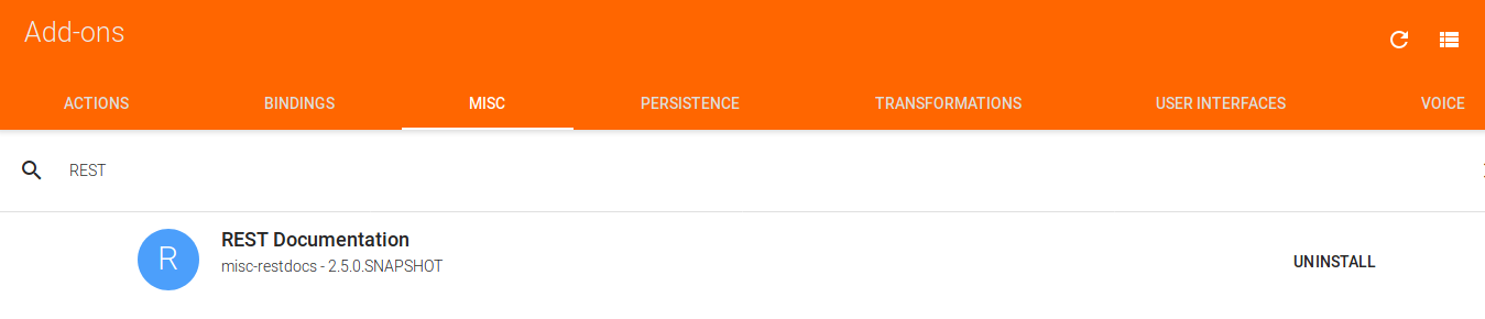

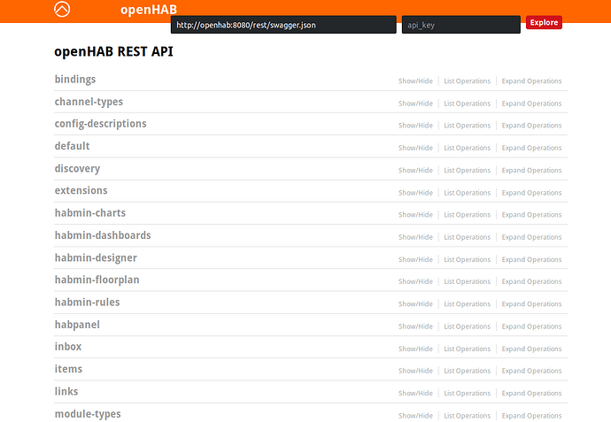

I uninstalled and reinstalled REST documentation and apart from a ton of NPE when installing the REST documentation, I still get “Can’t read swagger JSON from XXX”.
This appears to be a bug. I’ve filed an issue at [RESTDOC] Can't read swagger JSON · Issue #86 · openhab/openhab-webui · GitHub though it might be moved to openhab-core.
