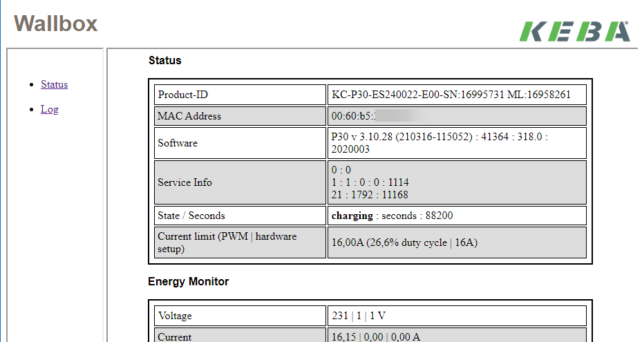

Additional Information (2022.04.08): I made an update of the KEBA Firmware to 1.13 without any changes. A screenshot from the openHAB UI, where you can see that the car loads energy, but power still is UNDEF. I am wondering nobody answered the last days. Are there no other users with a KEBA wallbox, who are interested in the power value?

KEBA can show all values I am interested in (including power), but ignores all commands:

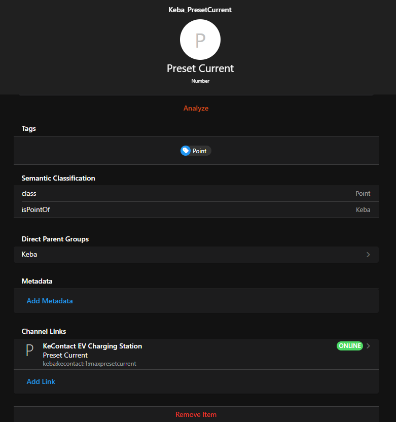

I tested my setup and comment the power item out, added a power item over the UI and got the value. But when I compare both, there is no visible difference. Frustrating.
