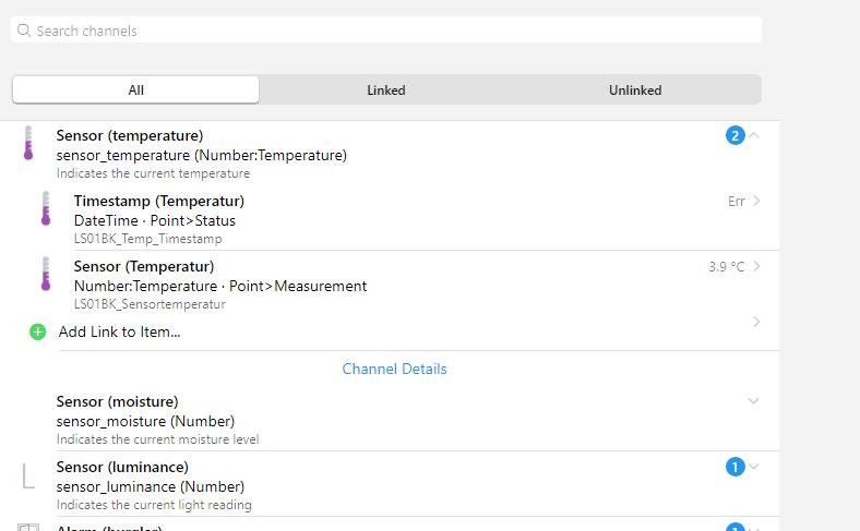

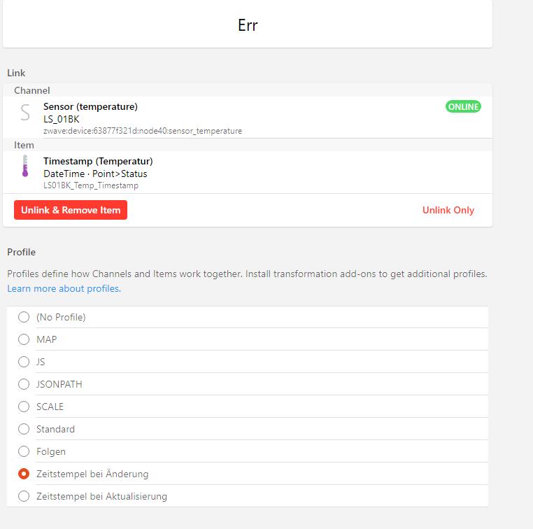

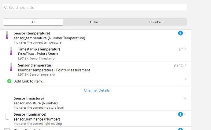

I installed a DateTime Timestamp item to a „binary“ channel (contact); which works fine. The next DateTime Timestamp item to an „analog“ channel (temperature) failed saying there is time conversion problem
2021-01-04 11:00:46.708 [WARN ] [e.internal.SseItemStatesEventBuilder] - Exception while formatting value '2021-01-04T10:49:18.095052+0100' of item LS01BK_Temp_Timestamp with format '%.1f %unit%': Conversion = 'u'
