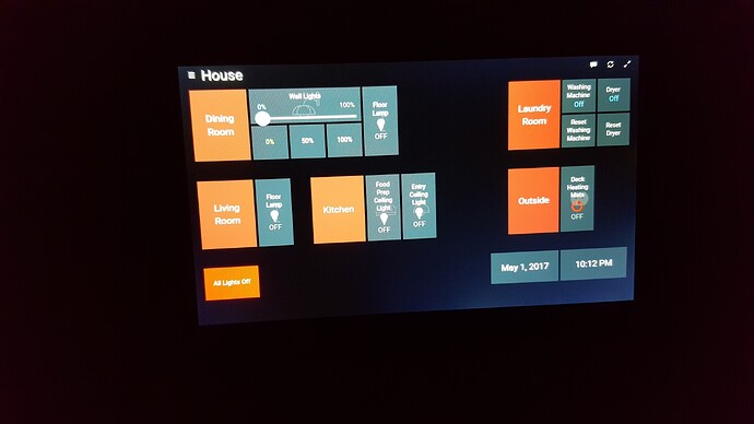

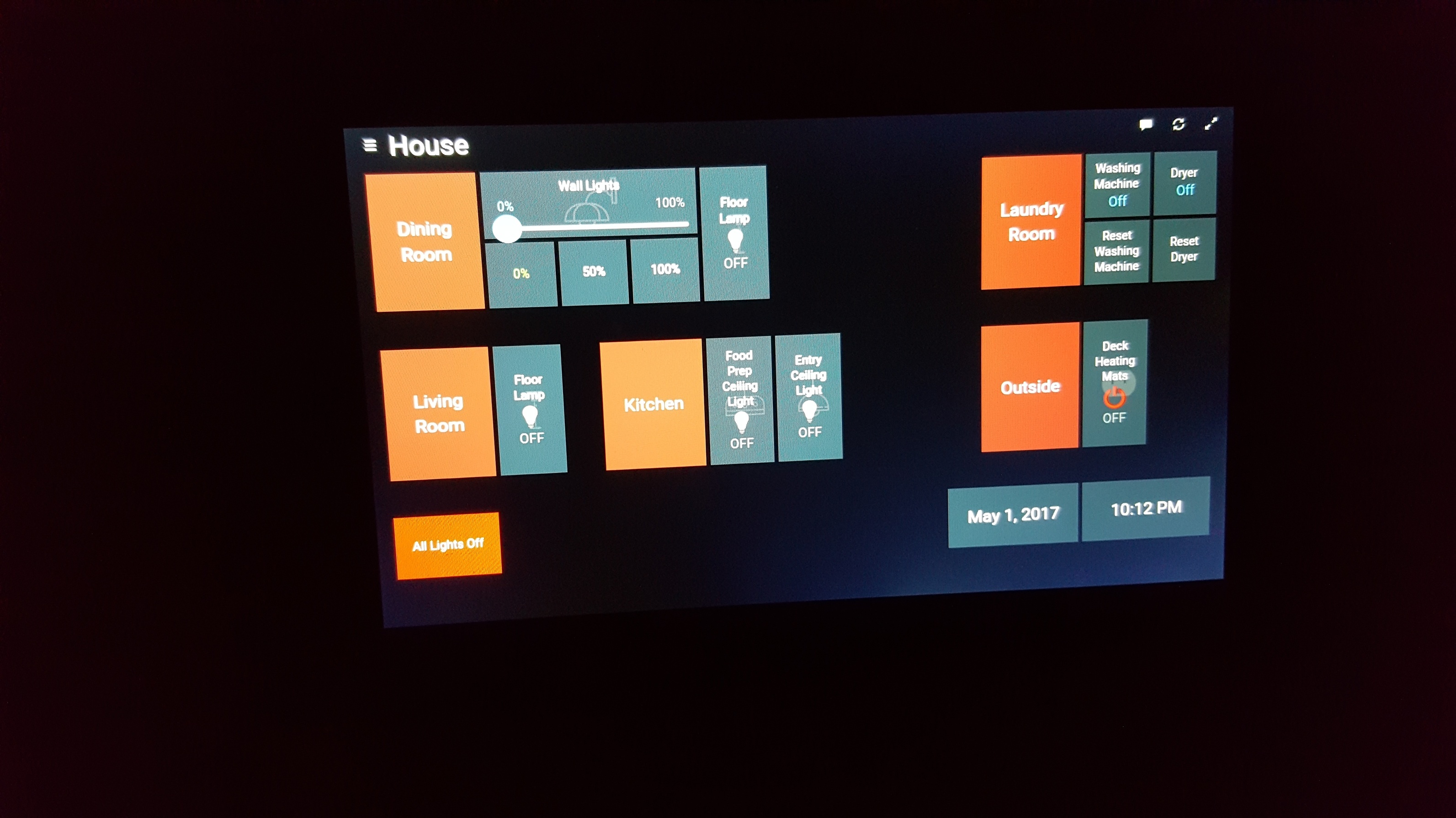

I am running HABpanel on wall mounted 7" Kindle Fires and had sizing issues when I started. I found that changing the number of columns for the dashboard provided greater flexibility in widget sizing and usable screen space. This can be changed from the “Advanced” tab in the dashboard settings. 24 columns worked well for my testing so far.
