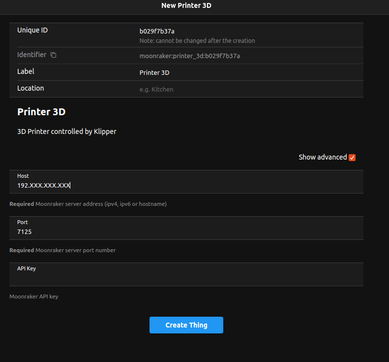

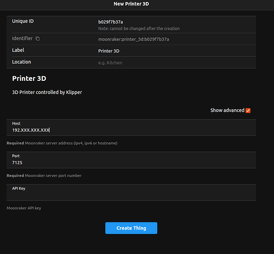

After dropping the jar at my openhab system, i added a new Thing via GUI:
And only had to configure the IP Adress of the Raspberry connected to my Printer (i never changed the port on the Raspberry with Klipper/Moonraker)

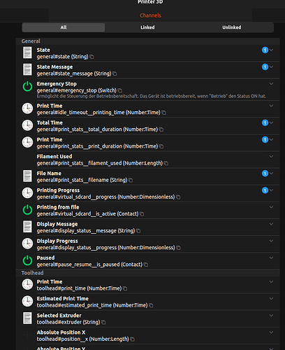

After creation of the Thing i added an Equipment with some of the given Channels:
An Description of the channels (apparently the name of the channels is not exactly the same as in the Moonraker documentation) can be found here Moonraker documentation
