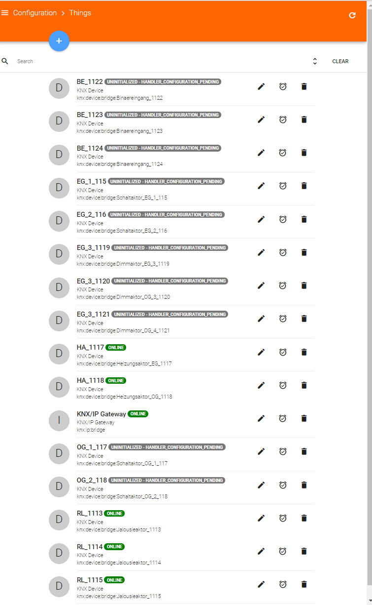

Hello everyone, hope you can help me.
I’m currently doing my mig from KNX1 to KNX2 binding.
I have added most of my actuators and Chanels to the things file.
I’ve checked the paperui from time to time to make sure everything fits.
Now that I’m finished of course, I always get the error “UNINITIALIZED - HANDLER_CONFIGURATION_PENDING”. but not at all things.
My question is now. Is there a limit on chanels or actors at KNX2 binding?
Tested on:
Fresh installed Openhabian 2.5 on Rasp.3
Fresh installed Openhab 2.4 on Synology
This is my things file, things.things.txt (14.2 KB)
Hope for your experience and thank you in advance.
Beste grüße
Angelo

Have a look at this issue on github https://github.com/openhab/openhab2-addons/issues/3414 is this the same problem you are having?
chrode
(pmc)
3
[knx=“1/1/116+<1/4/116”] schould be [ga=“1/1/116+<1/4/116”]

4
Thank you very much for your support!
@H102 and @chrode
Sometimes the solution is so simple.
@chrode proposal was right.
Thanks again
Kind regards
Angelo
