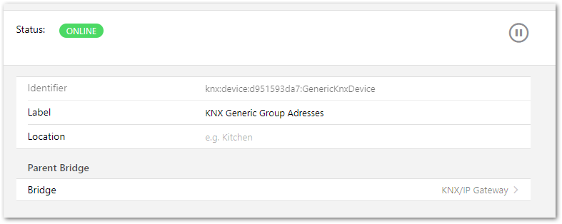

I will try to break the ice with my simple solution to your problem.
(At least i think i am trying to achieve the same as you. )

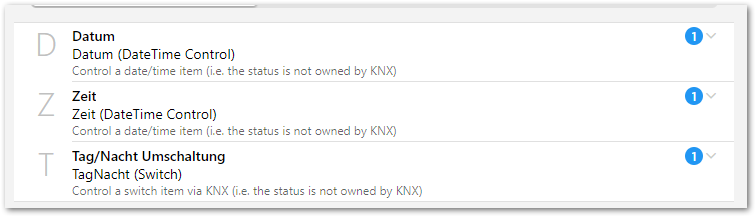

For central (i would call it generic) functions i have one thing that collects all channels that i can’t sort to one specific device.
I do this because i like to have those channels separated, but they would be fine in any device thing.
Basically with the knx binding you would only need one thing with many channels, but that would be a hard to maintain mess in bigger systems of course.
In fact I tend to call Confectricians solution “the common way” for such GA, as most users will do it this way.
Please be aware of the fact, that it is not allowed to set non-real individual addresses. Fortunately it is not necessary either.
The individual address has (in general) no effect for devices, it’s more a “nice-to-have” feature. So for a virtual device (i.e. there is no real device for this part of configuration) just leave the individual address empty.
