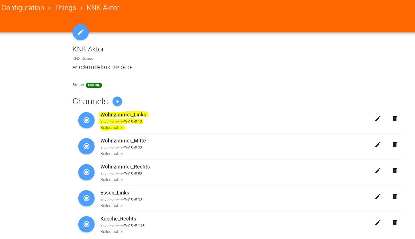

See my Actor and Channels:
Now i would like to put the yellow markt thing into my knx.items
Rollershutter KNX_Wohnzimmer_links  "Rollo Links [%d %%]"            <rollershutter> (GF_LivingRoom)  { channel="knx:device:bridge:generic:demoRollershutter" }
I have big problems by the {Binding} .. I do not kown what to put into it thats the shutter works ..
Could someone help me out ?
Greetings Henning

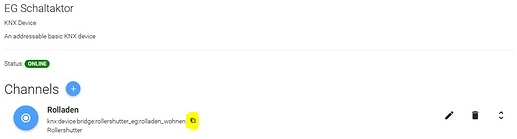

You have to name the channel according to your thing.
so it would be something like:
Rollershutter KNX_Wohnzimmer_links  "Rollo Links [%d %%]"            <rollershutter> (GF_LivingRoom)  { channel="knx:device:ce7e05c5:13" }
In my case:
Rollershutter knx_rolladen_wohnen "Rolladen [%d %%]" <rollershutter> (gRolladen, gWohnen) { channel="knx:device:bridge:rollershutter_eg:rolladen_wohnen" }
