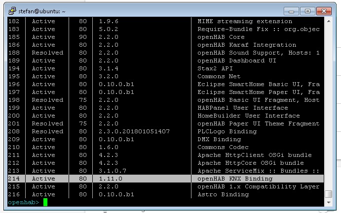

@Anton_Wedemeier: Thank you very much for providing your KNX binding. Will try this out first thing when I have time for (Wednesday I guess).
Just noticed that yours is “…1.9.0.jar” whereas mine is version 1.11.0 according to the following screenshot taken from Karaf console. I installed my binding using the PaperUI. Not sure but probably that’s the reason why even replacing the Calimero.jar didn’t work for me
