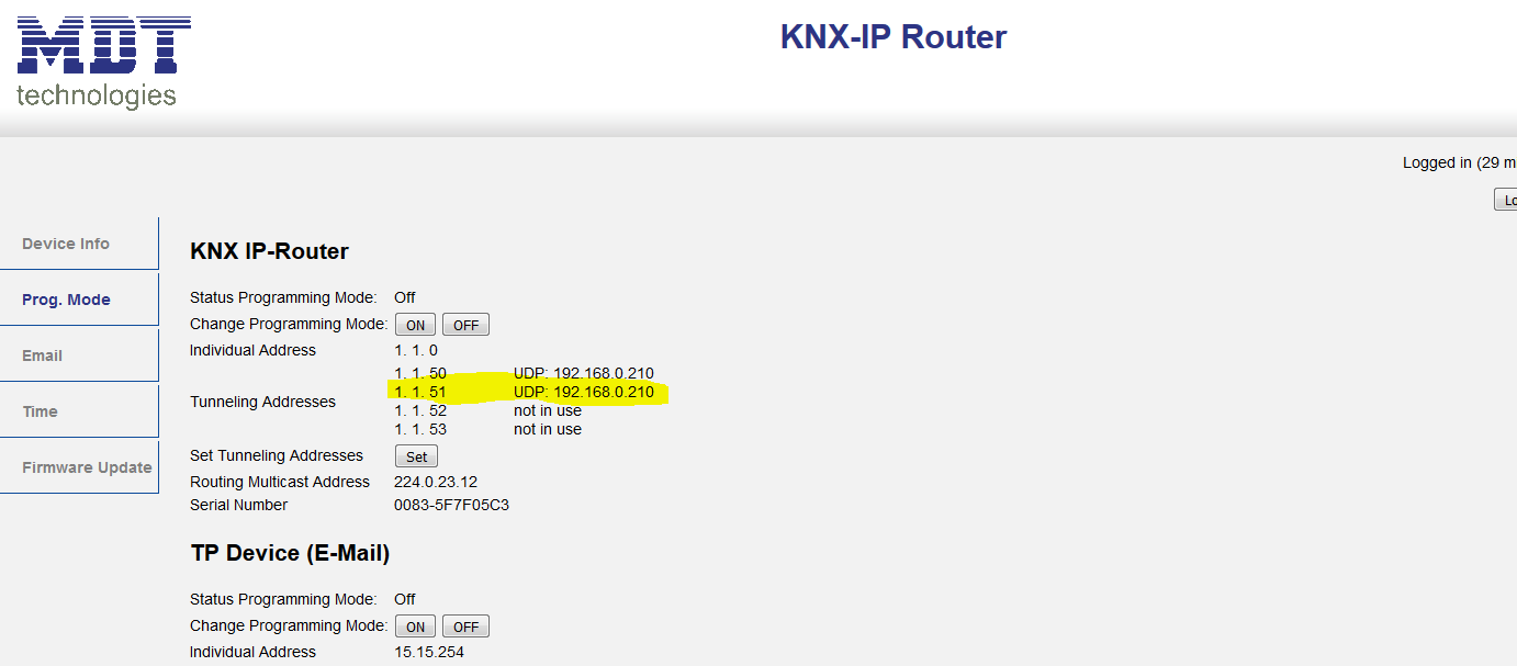

Hi Stefan, George,

does anyone have a working KNX connection in tunneling mode? (except Anton)
just noticed another strange thing:
two connections from OH2??
