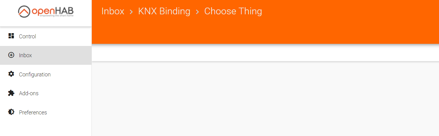

Also the Paper UI KNX Binding does not appear on the page.

I’m not sure that’s the case here. Look at the screenshot. He wouldn’t be able to browse to Inbox > KNX Binding > Choose Thing if the KNX Binding were not installed.
@serkan, did you create the KNX Bridge? You need to create the Bridge Thing first. There should be an option the “Add Manually” or something like that on the page you screen shotted. I don’t use this binging so am limited in how much I can help but I can help with some of the basics like this.
