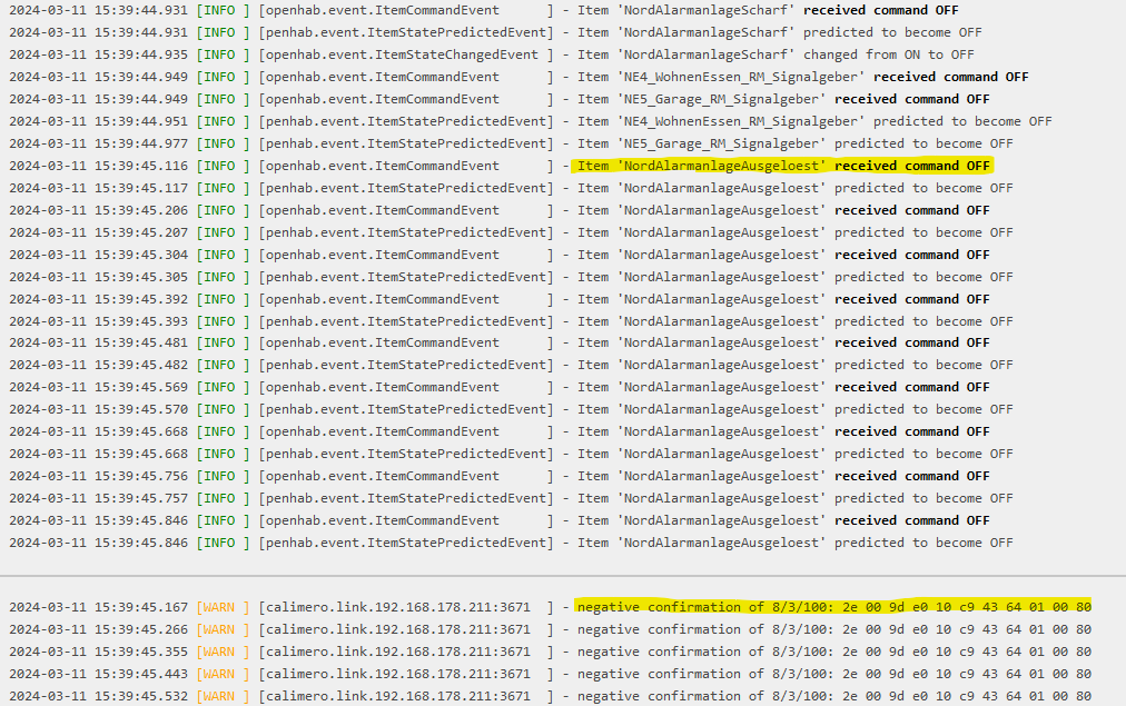

I have the problem, that after a “postUpdate” to a switch-control item the event log is flooded with many warnings “negative confirmation of 8/3/100: 2e 00 9d e0 10 c9 43 64 01 00 80”. This warning comes every 100 ms.
This happens with other *-control items as well.
I’m using openHAB 4.1.1. I think this didn’t happen in the versions before.
It’s a litte bit annoying because the log is flooded with this warning until a complete restart of openHAB.
Is it a bug or a mistake in the definitions? Does anyone have an idea what’s wrong?

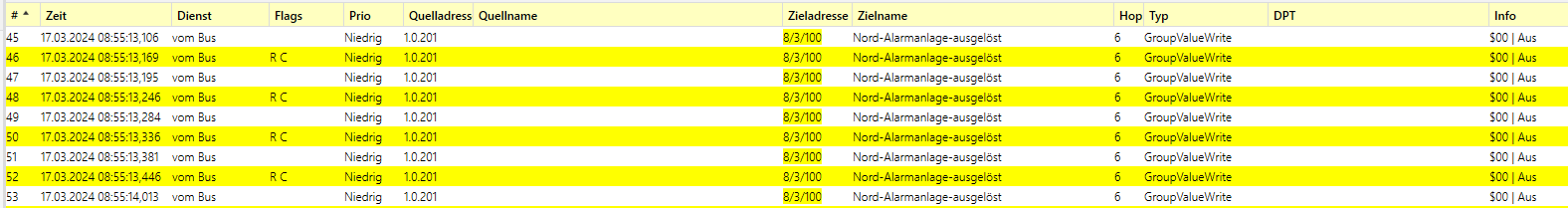

Please have a look into the Monitor in ETS and share what is happening there, filtered on the involved Bus Addresses.
And shame on me - you led me in the right direction. I had an mistake in ETS so that the KNX group address 8/3/100 was not used for any device (only in a dummy device for the line coupler).
So that was the problem, that no device was acknowledging to that group address.
