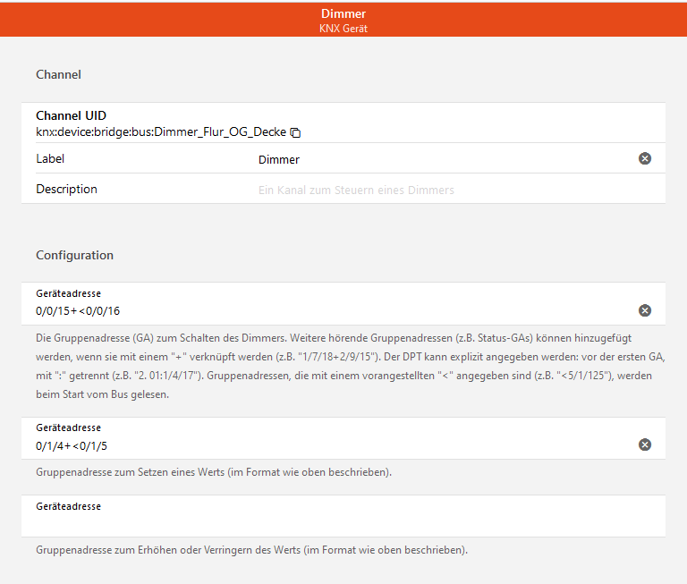

I have defined my things in a file but items were created via main UI.

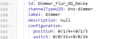

Don’t use a status GA on switch, a channel can only have one status, and that’s the dimmer level, not the switch status.
I’m not sure if the DPT is still necessary, but it was in OH2 for each parameter with more than one GA (just for my system…), so my configuration is still in this format.
So I removed the reading GA from the switch and also prefixed the position with 5.001. Nothing really changed. I double checked in main UI that the changes from the thing file were ending up there. Actually just tried a restart - no change.

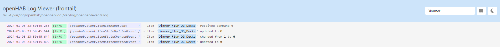

Coming back to the logs that are printed when I usually move the slider:
When it stops working, those logs also stop. So if this is a KNX setup issue, I would expect the logs to still appear (as the state changed in OH), but publishing it to the KNX binding should throw an error or silently fails or so. But just guessing here…

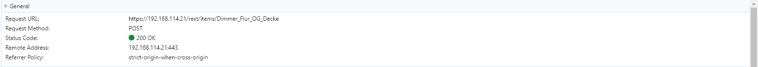

So I enabled Web Developer tools on Firefox and can see, that when I move the slider, it sends one request to Openhab with 200 ok for the Dimmer with a payload of “0”.
After that any movement I do with the slider does not trigger any further request to Openhab. That can’t be right. I tried the same with Chrome. I also did the usual SHIFT-RELOAD in FF.
I would say it looks like a UI issue then?

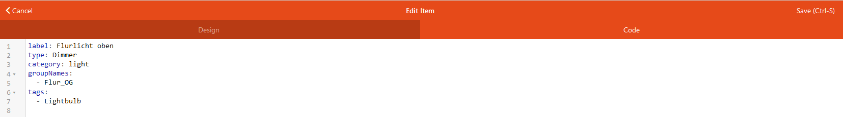

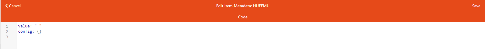

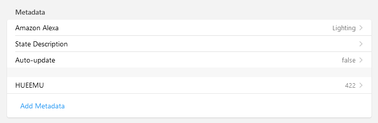

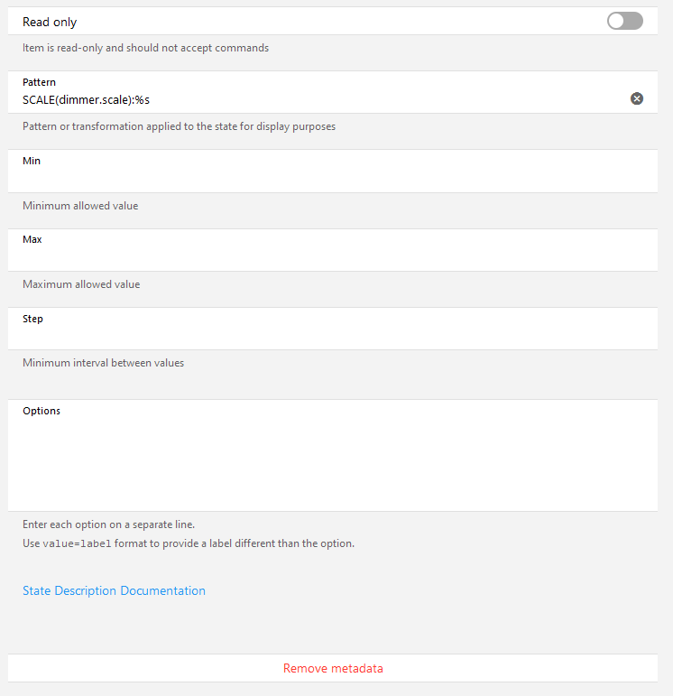

I am still not used to UI stuff. But indeed I don’t have any metadata but if I add one I can remove it. Show more details qbout your state description?
No, increaseDecrease is not (and never was) DPT5.001 but DPT3.007.
Actually, openHAB will never send commands INCREASE or DECREASE if you don’t use OH1-2 with Classic UI or use an extra rule to explicitly send these commands.
You have to check the GAs for its function. Is it both really percentType, so you are able to control the Motor from 0% up to 100% infinitely? Which GA is to control, which GA is for feedback?
