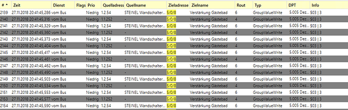

I have a steinel presence detector which allows to change the sensitivity through the bus. You can send a value from 1-4 which is the sensitivity, it is DPT 5.005 according to the detector’s manual. I created the item like this:
Number BM_Sensitivity "Bewegungsmelder Verstärkung Gästebad [%d]" { knx="5.005:5/0/8" }
It correctly reads/updates the item’s value if I change the sensitivity on the bus through ETS. Unfortunately when I change the sensitivity through openhab (for example with a Setpoint
in a sitemap), it gets in an loop and does not stop until I remove the item. For example I tried to change it to “3”:
You can see it is sending the value “3” (from 1.1.252) and the presence detector is confirming the value (“1.2.54”), though it goes on like this endlessly.
I tried it with multiple sitemap items, the last one I tried is:
Setpoint item=BM_Sensitivity minValue=1 maxValue=4
What can trigger this behavior?
