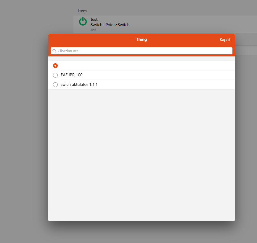

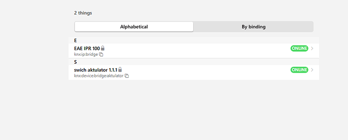

I have a KNX IP router, and I want to use it with OpenHAB version 4.3.2 to control my KNX system. However, I haven’t been able to make it work. I installed the KNX binding from the Add-on Store and configured the router’s IP settings, but the device is not recognized. Could you please guide me step by step on how to resolve this issue?
Thank you in advance!
Is it a knx/IP router or a knx/IP tunnel Gateway? Which model?
If using the router mode, all you need to do is to set the mode to ROUTER. knx/IP routers use multicast IP 224.0.23.12. So you should not need to configure that part.
Please set localIp to the IP of your openHAB Server. Please leave all other parameters empty.
If using the tunnel mode, you will need to set ipAddress to the IP of the gateway (most likely 192.168.x.y, where x and y depend on your configuration). all other parameters should stay untouched.
The gateway should change online within seconds.

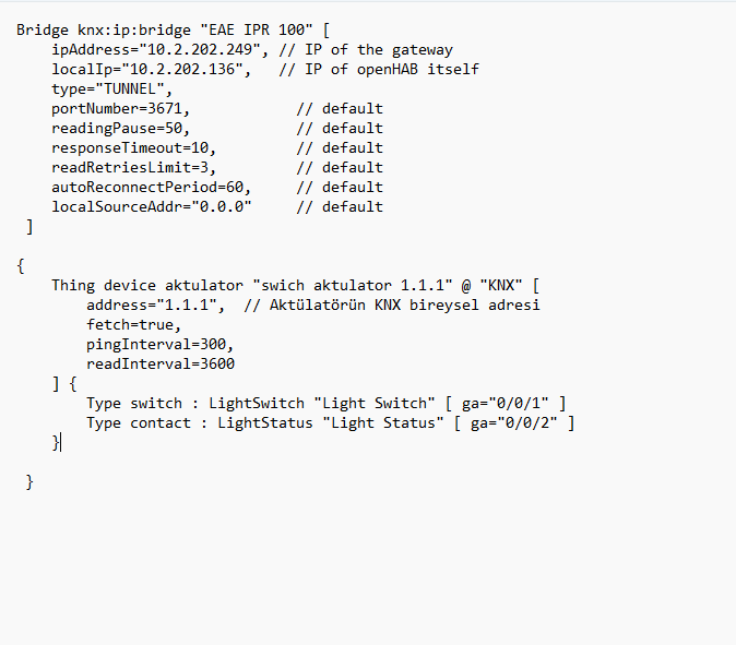

Thank you for your response. The configuration below works perfectly with version 3.4.4. I save these settings as a .things file and place it in the things folder, and my device comes online without any issues. However, when I load the same configuration in the latest version, I receive an error stating that the device is not ready. Could you please provide an example configuration compatible with version 4?
Best regards.
// Router Bridge
Bridge knx:ip:router [
type=“TUNNEL”,
ipAddress=“10.2.202.249”,
portNumber=3671,
localIp=“10.2.202.136”,
readingPause=50,
responseTimeout=10,
readRetriesLimit=3,
autoReconnectPeriod=60,
localSourceAddr=“1.1.0”
Example (from the Code Tab in MainUI) of an MDT Gateways working fine below.

This is my configuration (works since ~OH2.3):
Bridge knx:ip:bridge "Weinzierl 730 IP" [
    ipAddress="192.168.178.77", // IP of the gateway
    localIp="192.168.178.66",   // IP of openHAB itself
    type="TUNNEL",
    portNumber=3671,            // default
    readingPause=50,            // default
    responseTimeout=10,         // default
    readRetriesLimit=3,         // default
    autoReconnectPeriod=60,     // default
    localSourceAddr="0.0.0"     // default
So it looks more or less the same as yours (except local source address, which should normally be set to 0.0.0)
Please be aware that localSourceAddress must not be a individual address of any hardware at the knx bus. It has to be an unassigned individual address, or at least there must not be any hardware which uses this address, including the interface (!)

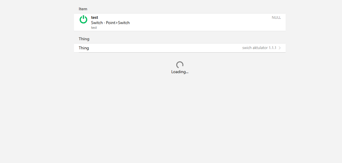

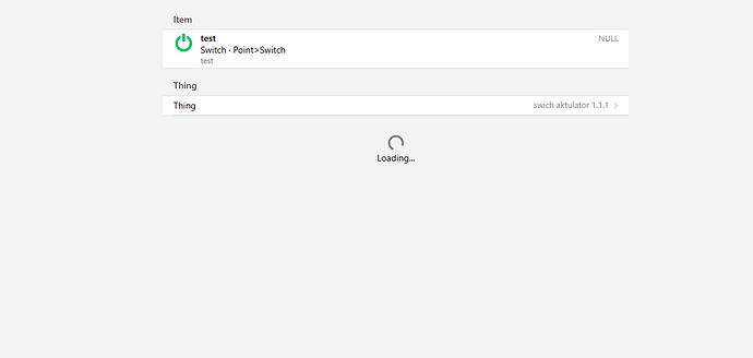

Thank you for your responses. I was unable to get it working with version 4, but my device functions correctly in version 3. I have another question. I add the devices shown in the attached screenshot to the things folder. However, when I add a switch in the items section of the web interface and click on Add Link, I select the actuator I want to control from the things section and click confirm. Despite this, the “loading” message remains stuck on the screen, and the process doesn’t proceed further. What could be the cause of this issue?
Thank you in advance.
Best regards.
I have no idea. Sometimes there are caching problems in the browser…?
In question of your thing: please set fetch to false an readInterval to 0.
fetch is to get additional information about the device, but there are many devices which don’t support the query, this can lead to problems, and there is no real functionality here.
readInterval is to enforce read requests for all queryable group addresses of this thing. This is only necessary if the device itself is not able to send on changed values, and therefor another device has to query the value active. And you didn’t configure a group address to be queryable anyway.
