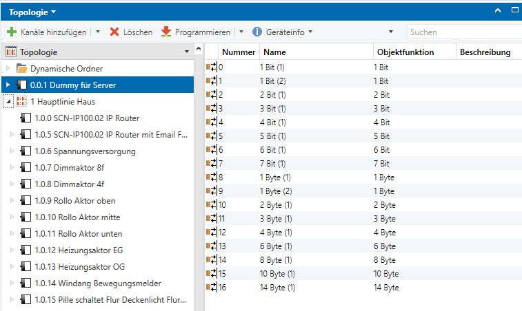

The ETS Topology looks as follows:
I also had once a “Dummy App from Gira” introduced, but not configured - would this be the starting point?
Also I have all Devices in the “1 Hauptlinie Haus” no additional lines

It depends wether all KNX devices are in the same line (which might be extended by amplifiers) or if the devices are in different lines, connected by line couplers with activated filter functionality.
In the first case all KNX telegrams will be visible to all devices. In the second case you will need the dummy device.
To use it, you place the device in the line where openhab us connected. The dummy device has to be connected to all GAs from devices outside that line, that should be visible to openhab. This allows the ETS to calculate the filter tables of the couplers. After that the couplers have to be reprogrammed.
In a one family home (what is the correct english term for the german „Einfamilienhaus“) I would personally use the line couplers in amplifier mode, so that all devices can see each other. In this case I would use couplers with filtering only for security reasons, e.g. for devices outside the house or where others have access to.
