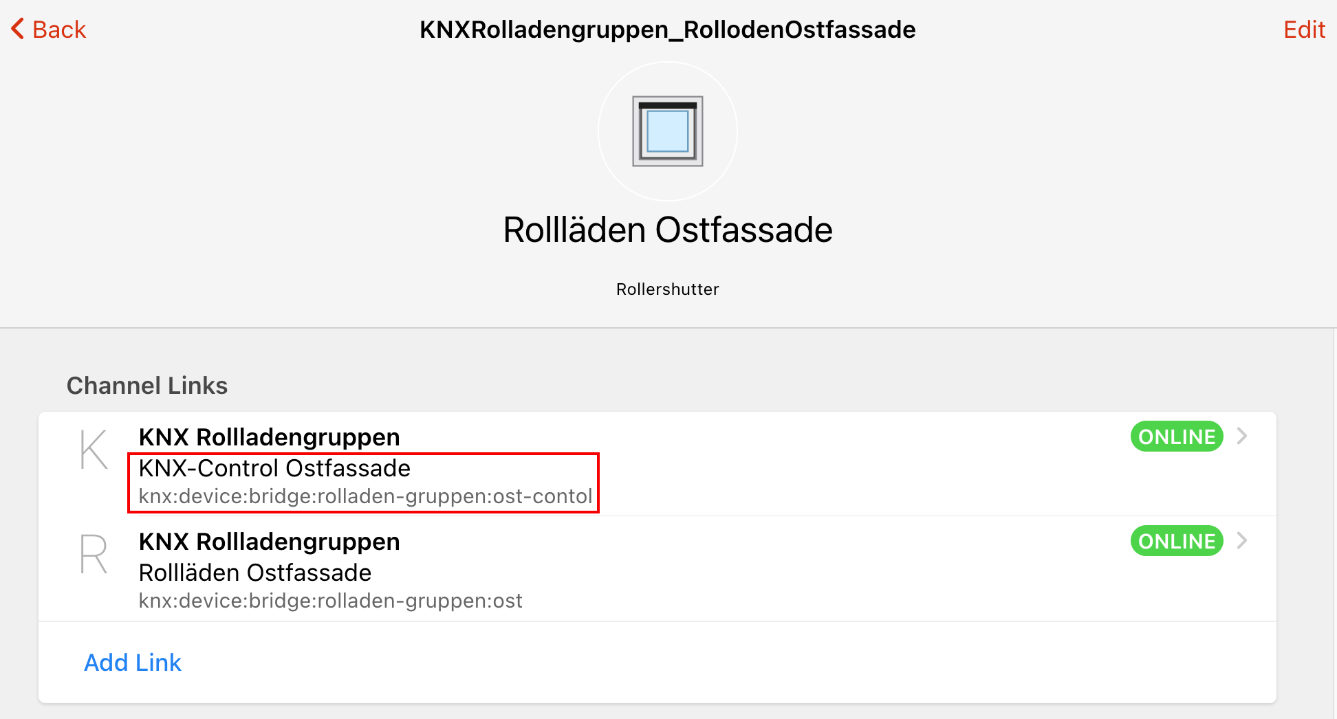

So every rollershutter-channel for the three facades got a supporting “*-control” channel where the associated GA’s are set just for listening e.g. ga="<..."
Doing so, I was able to connect both channels for a single facade to the the rollershutter item:
  • the common channel using the ROLLERSHUTTERPOSITION profile and the
  • “rollershutter-control”-channel using the standard profile:
Doing so, the item states get updated even in cases when the movement is triggered from KNX side.
