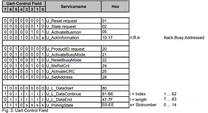

When I add it, openhab send 10 40 40 16 (HEX) to the selected com port, TPUART sends an answer 47 (HEX). As I understand this answer meaning an error, cause TPUART chip doesn’t have 40(HEX) register.
I can’t understand, why openhab trying to read nonexistent KNX registers.
