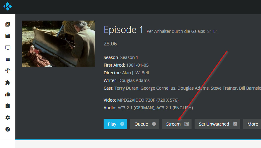

When you navigate to the Kodi webinterface (it’s on port 80 in my installation), can you view the stream?
It doesn’t work for me, but maybe you can use it somehow to get a stream to your HABpanel.
