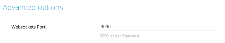

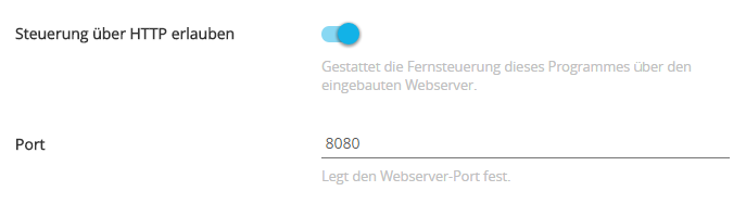

Before writing i have checked the ports:
and
Everything is set up according to the docs.
