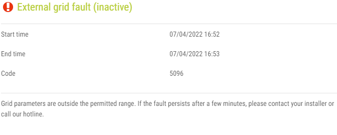

Question: is it also possible to get the Event-Message from the inverter? The local portal of the inverter shows Events with the following information:
For monitoring it would be great to have this information in OH3 to process it further. Any hints how to get this information?

thanks for your info. I’m interested in the whole message. Is it structured like:
or like:
My goal is, to have a Monitoring about the errors so that I could react in case of severe errors.
KR
Frieso

Hi @frieso,
I have found out how to catch the information from inverter you are looking for, so far so good.
So then is my question right now:
Are you interested to have all these responded parameters and if so, then presentated in one channel for each parameter?
The parameters are as: is_active, description, long-description, start-time, end-time, category, group, code.
Br Basse
Hi @Basse_03
Great you could find those values!! Yes to have them all as a channel would be great so I could on one side make a nice “error-dashboard” with the description / time Info’s and on the otherside create rules of action with the category, group and code information.
