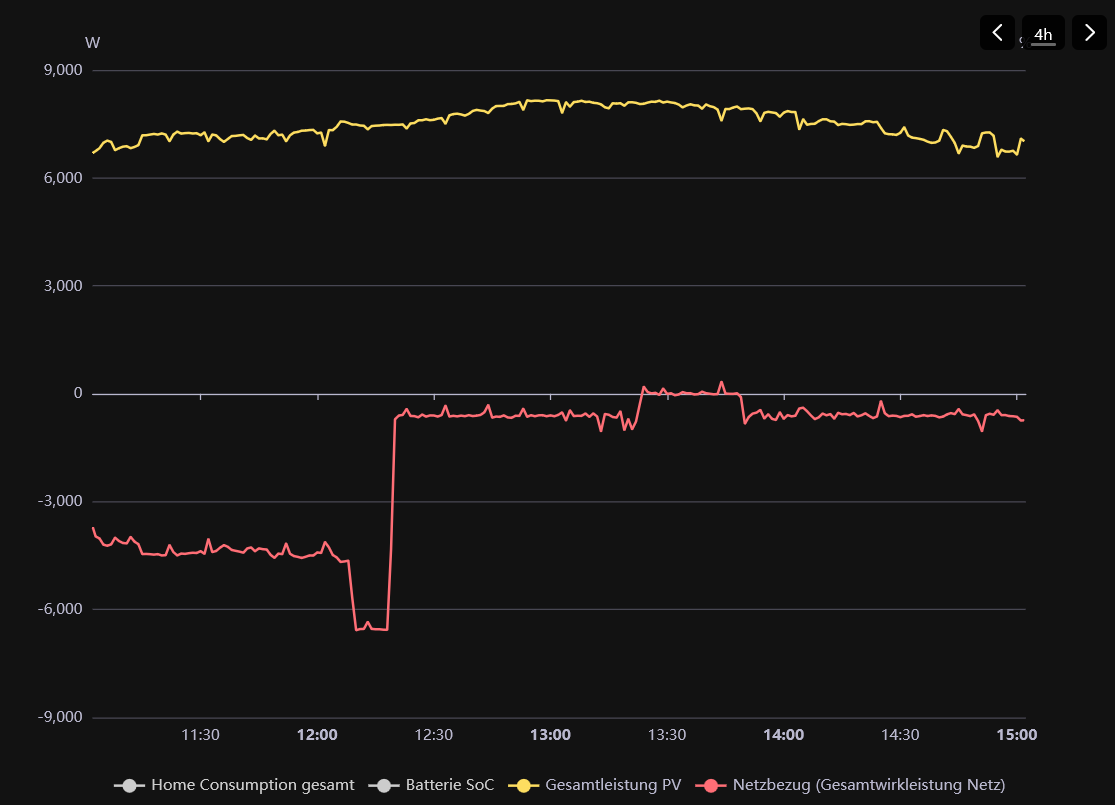

I do read-out my Kostal Plenticore 10 plus via Modbus. Usually I use “rrd4j” as standard persistence, which has the following readout:
grafik
yellow: PV Power
red: grid consumption/feed in

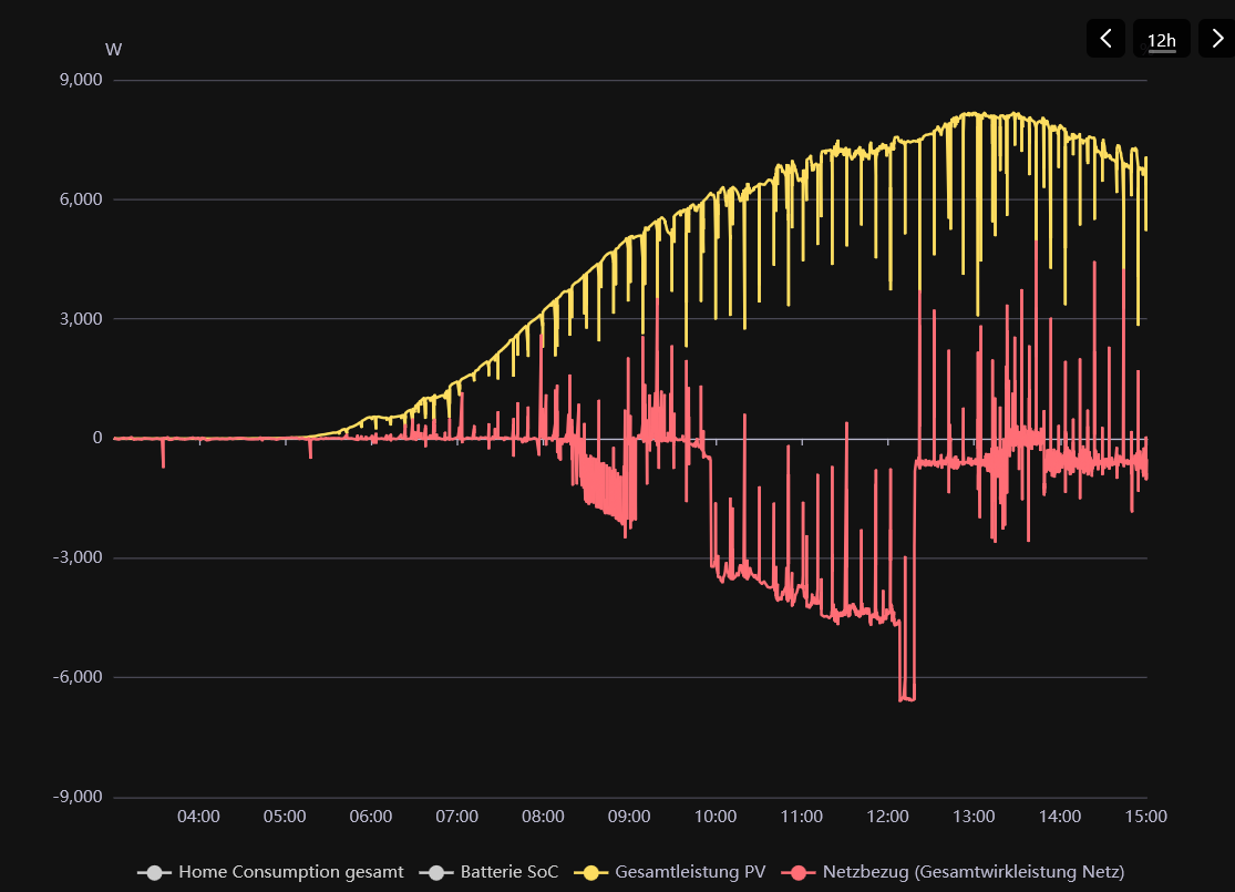

as forecasts cannot be used with rrd4j I change standard persistence to JDBC (MariaDB), which draws this graph:
grafik
colors as above.
Is this “common” behaviour with Kostal inverters? Do I have some kind of error in my Modbus configuration? the drops in PV Power correspond with drops in feed-in, so it is kinda syncronous and plausible - and rrd4j smoothens the peaks out?

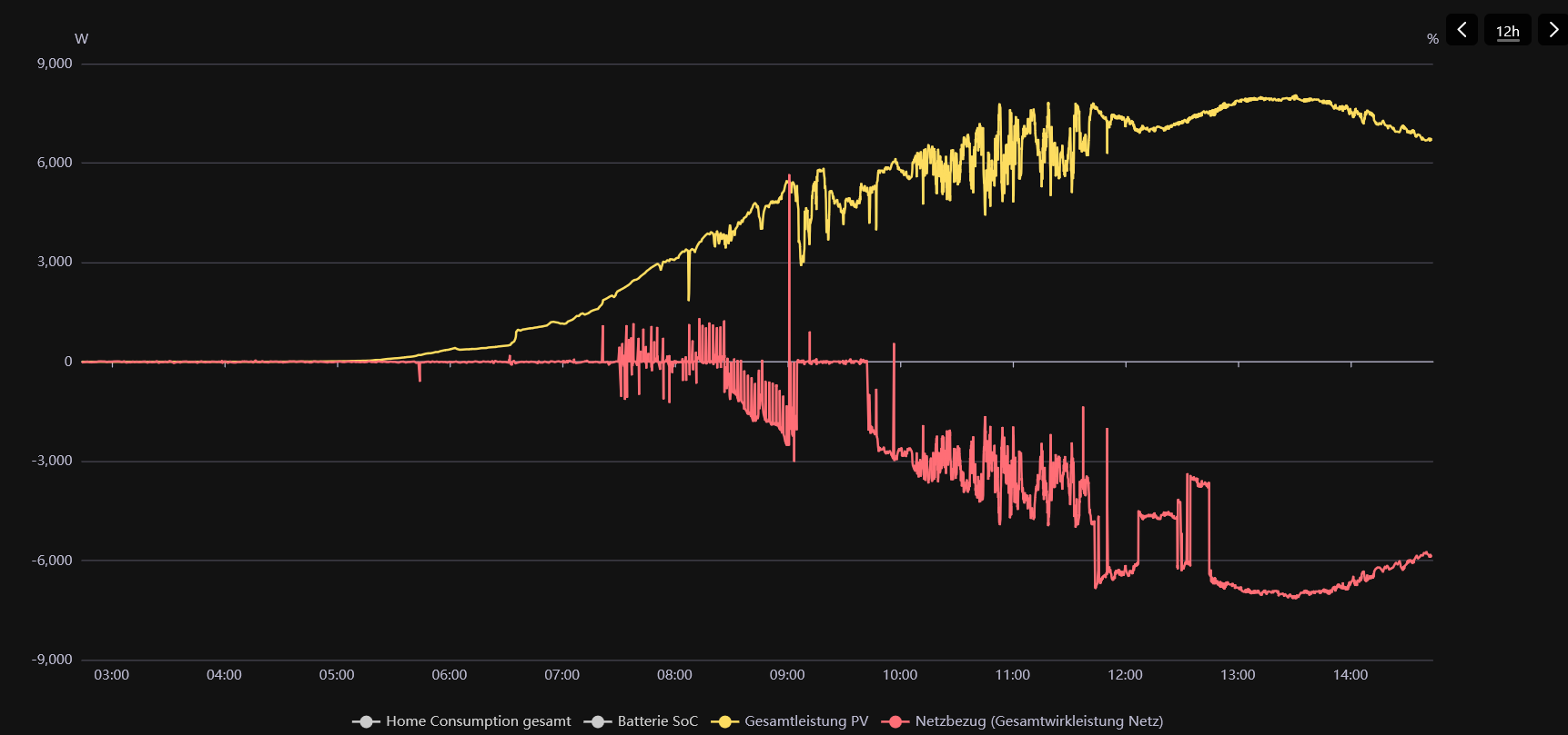

I’d like to solve. The culprit is the activated “shadow management” of the inverter. As I don’t have any shadows for both my roof sides, I just deactivated it after an tipp from a PV forum.
So now it looks like this with JDBC persistence:
