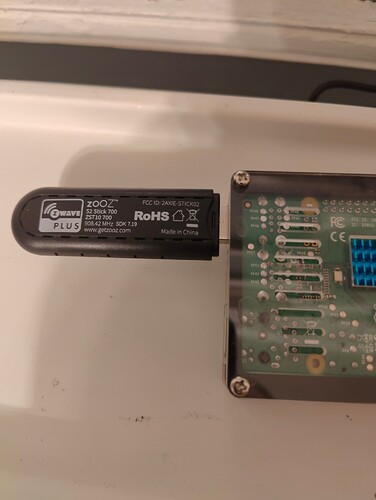

the model i am using is " Zooz 700 Series Z-Wave Plus S2 USB Stick ZST10" available on Amazon

This is going to sound dumb, but can you check the label on the underside of the stick to make sure it says 700? I’m not doubting that you ordered a 700, but Zooz’s 500 and 700 controllers have the same S2 ZST10 name/model and are physically identical…except for the label. So it wouldn’t shock me if you got sent an older 500 model.
If not, I might order one to see if I can also get it working. Annoyingly, it’s more than 2x the price in Canada.
it says S2 stick 700, i did install the updated addon coded for this stick…so I think the updated addon is the fix along with the 914C is basically the same hardware/firmware as the 916SC. Looking as the manuals and troubleshooting for both the have the same steps for setup and procedures…
