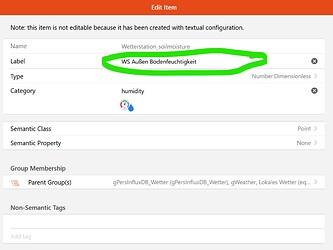

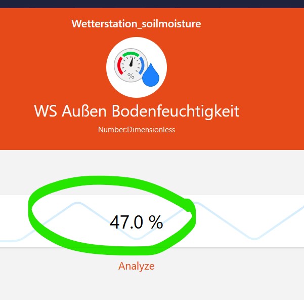

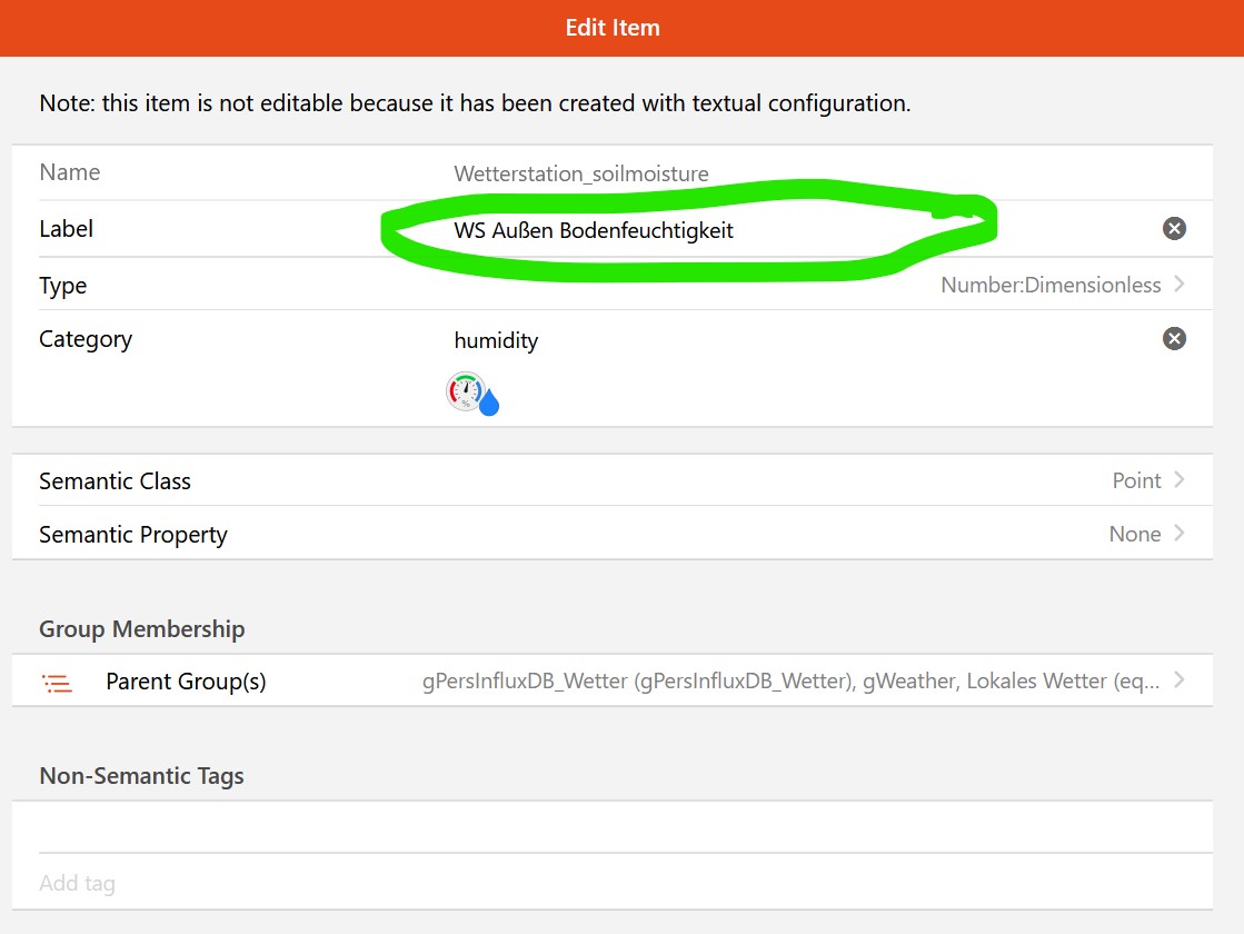

An item defined in an .items file with " [%.1f %%]" in the label
Number:Dimensionless            Wetterstation_soilmoisture      "WS Außen Bodenfeuchtigkeit [%.1f %%]"       <humidity>       (eq_LokalesWetter, gPersInfluxDB_Wetter, gWeather)             ["Point"]
shows up in the UI as

  "label": "WS Außen Bodenfeuchtigkeit",

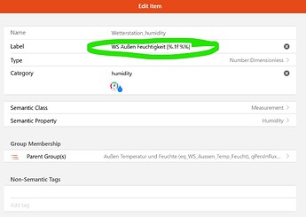

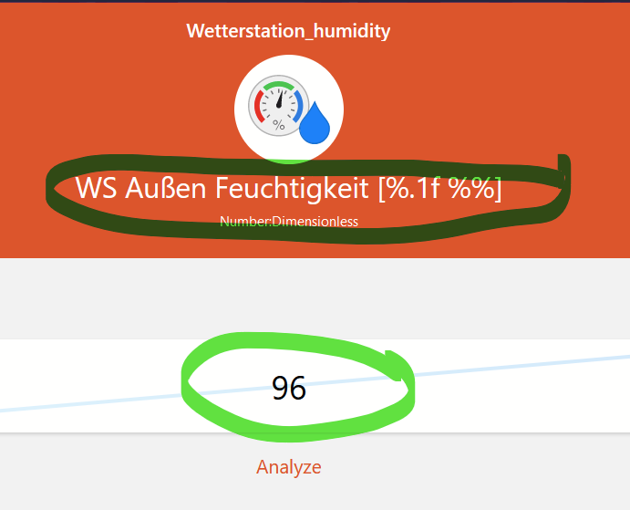

Number:Dimensionless            Wetterstation_humidity          "WS Außen Feuchtigkeit [%.1f %%]"            <humidity>       (gPersInfluxDB_Wetter, gWeather, eq_WS_Aussen_Temp_Feucht)         ["Measurement", "Humidity"]
and the item via the REST-API

  "label": "WS Außen Feuchtigkeit [%.1f %%]",

Using the .items file the label and values are shown/displayed as expected.
After adding the items with “Add Items from Textual Definition” the label and values are shown different and not as expected.
The difference what i can see in the REST-API output is that using the .items file the format from the label is transferred to metadata-state description-pattern.
If you add an item via “Add Items from Textual Definition” the label is untouched and not transferred to metadata-state description-pattern.
Is this a bug and maybe already known?
