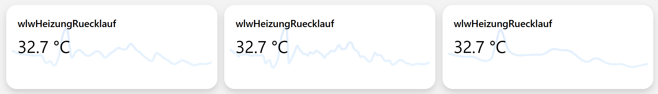

trendSampling only increases/decreases the accuracy of the graph within the same time interval:
  • trendSampling < 60 = higher accuracy
  • trendSampling > 60 = lower accuracy
This is the sampling rate in the same time window. You can see in the screenshot where the left cell has the default (trendSampling=60) that the middle graph (trendSampling=30) is finer and the right graph (trendSampling=120) is smoother. This is because there are more data samples in the same time in the middle graph (every 30 seconds) and less data samples in the right graph (every 120 seconds) - and they all are showing the same time interval:
So the trendSampling does not increase the time interval.
