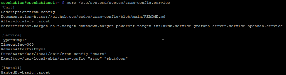

Check /etc/systemd/system/zram-config.service if it has influxdb.service in the Before=... line,
eventually add it then do not forget systemctl daemon-reload.

Now this is relatively fresh 3.1 install with 3.2 upgrade. This is Z-Ram config.
