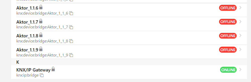

Now, the switches, but sometimes with tremendous lag (15 secs)
The dimmer doesn´t work at all (addresses are correct)
The channels are ALL offline, the gateway is online
Several questions:
  • Where could the lag come from ? (it´s sporadic)
  • Why doesn´t the dimmer work ?
  • Why are all the channels offline ?
  • What´s the best approach for analysis ?

Try like this but keep in mind that the router needs multicasting to work so check with your router for igmp to be disabled also check the load on your bus and if the trafic is below 5 percent then try readInterval of the thing to lower it but preferably adjust the devices to send the value after each change
