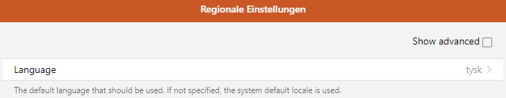

In this example German is configured as language (shown as “tysk” because of browser settings set to Danish). Headline is “Regionale Einstellungen”, so German. Everything fine so far. Now, let’s go back to my initial settings:

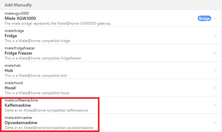

Now, with English configured as language, let’s have a look at the things from the binding where two strings now exists in English (miele.properties) and Danish (miele_da.properties):
These strings are displayed in Danish because of browser settings. Is this behavior intentional - and perhaps documented somewhere?
