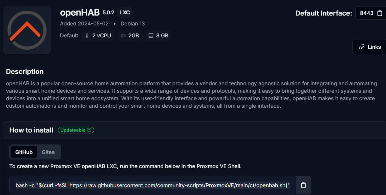

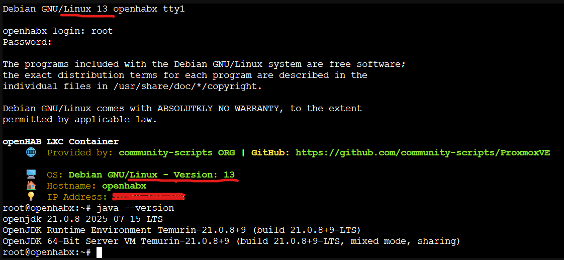

Thank you very much for providing OpenHAB 5.0.2 as Proxmox LXC. Openhab runs on Debian 13 (Trixie) - Great!
@Larsen did you already discuss the issue with the proxmox-support team ⌠or is it just the last provided version?
5.0.2 was just released this morning. Itâs the version tagged with âlatestâ on GitHub right now.
5.0.2 is just the latest release within the openhab repo. Thatâs why itâs installed.
Hereâs my current take â Iâm definitely not an expert in this (or anything else), so feel free to correct me or share your thoughts.
As mentioned, the Proxmox helper scripts donât have an official support team behind them. They were originally created by tteck and are now maintained by a community.
Iâm starting to think that supporting OpenHAB as an LXC install might not be the best idea. I looked into some of the other scripts that would be relevant for OpenHAB, and honestly, a few of them seem a bit outdated or pretty basic. For example, Zigbee2MQTT gets installed the same way as OpenHAB â always the âlatestâ version â without considering the guided setup. Thereâs no MQTT server included, so most people would probably end up creating another LXC just for Mosquitto, which doesnât make much sense.
At first glance it all looks super easy, but the risk is ending up with a messy or partially outdated or non-efficient setup.
On the other hand, the Docker images for OpenHAB, Zigbee2MQTT, EVCC⌠are all provided directly by the developers, so theyâre always up to date. Thatâs why, if youâre running Proxmox, I think going with a Docker LXC for OpenHAB is the better option for the semi-skilled user (like me).
Nevertheless it would make sense to correct the helper script so that it allways installs the latest major version.

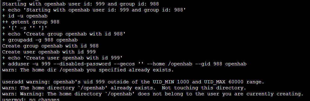

Sorry, I have a question because Iâm not a Linux expert and not a docker expert.
I created the âopenhabâ user according the âopenhab dockerâ documentation https://www.openhab.org/docs/installation/docker.html
to run the openhab docker image I need the uid and gid of openhab
the ids have been provided with âid openhabâ uid=999 and gid=988
⌠but the openhab docker documents say
By default the openHAB user in the container is running with:
uid=9001(openhab) gid=9001(openhab) groups=9001(openhab)the by default uid=9001
I first tried uid=999 and gid=988 in the docker run command ⌠and I thougt everything is right as I didnât get an error message and openhab could be started on the WEB. When I tried to get e better understanding of docker I used the command âdocker logs openhabâ and found the following warnings:
I stoped and removed openhab and started openhab container with run and uid=9001 and gid=9001 but again got a similar error message in the docker logs. A third try with again with uid=999 and gid=988.
I am not sure what the implication of the warnings will be ⌠possibly some data will not be stored. Does the openhab user and group within the docker image have the same ID than on the linux system (or is it similar to the port mapping)? May I need to define the uid=9001 and gid=9001 while I create the user on the Linux system?
Sorry, this might be the problem of my âhalf knowledgeâ of docker. Could possibly avoided by a improved documentation.
Any idea what to do? Ignore the warning or fix my system and understanding? Sorry!
Nothing like that. UIDs below 1000 are usually reserved for processes to run under. When a new user is created using adduser it prints a warning reminding you that if this is a userâs account as opposed to a serviceâs account, itâs outside the range of UID numbers.
Itâs more like the port mapping. Each container has their own users and groups. However, when using mounted folders as volumes there is a little bit of overlap because all the files in those folders will be owned by the user as it is defined inside the container. Itâs a good practice to create a user on the host with the same UID and GID as the service is running as inside the container so that youâll see

Itâs not required but itâs what I would recommend. Or continue to use the 999 and 998 UIDs. As long as they are not already in use, it doesnât really matter.
This is more of a base Linux knowledge issue than a Docker knowledge issue.
I recommend:
- create an âopenhabâ user on the host with UID 999 and GID 998 (which I think youâve already done.
- start the container passing the UID 999 and GID 998
- make sure the userdata folder and conf folder passed into the container are owned by openhab:openhab
The container will fix all the rest of the permissions and ownership as required automatically.
