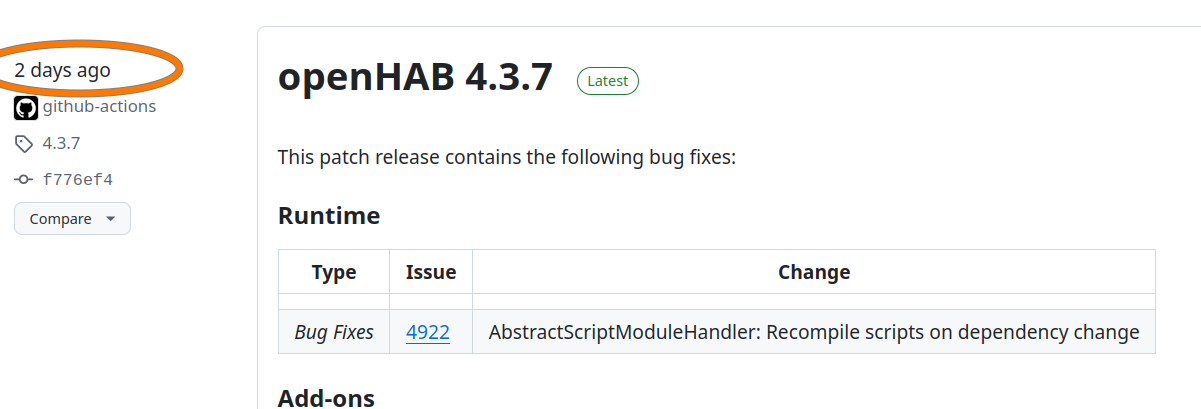

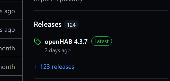

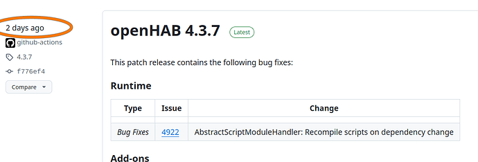

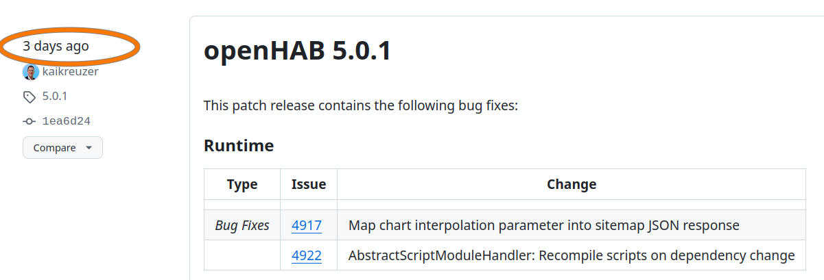

Latest version 4.3.7 on GitHub instead of 5.0.1(?)
I was looking for the change log for 5.0.1, but on GH I see 4.3.7 as the latest version. Why is that?
Because GitHub shows the most recently released version there regardless of the version number. Some bug fixes were back ported to OH 4.3 to create version 4.3.7 but this was done after OH 5.0.1 was compiled and published as a release. If you click on that “+ 123 releases” you’ll see 5.0.1 as the release right before.
In short, GitHub is only going to show the most recently compiled release regardless of version number. As long as OH continues to support previous versions with bug fixes you cannot rely on that one entry shown on the main page and need to click through to the full list of releases to be guaranteed to see the most recent one.
Thank you for explanation. Have a nice weekend.
@Kai Can you mark 5.0.1 as the latest release?
It seems, someone else was quicker than me…
I did that :backhand_index_pointing_down:

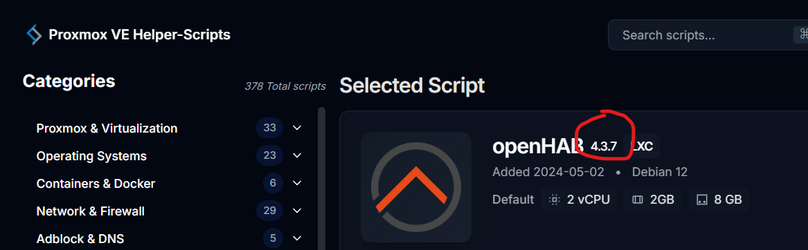

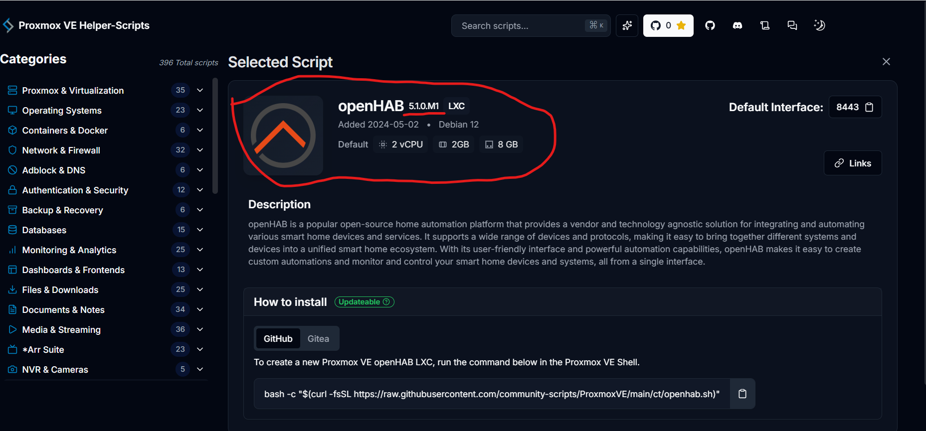

Proxmox community script still shows Openhab 4.3.7 on 29. Aug. 2025

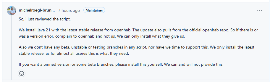

… and the following reply on my request on Github Proxmox community-script forum:
I think this person didn’t understand what you are asking about. We have no control over what’s shown on that page. That page has nothing to do with the openHAB project. I looked at the script and indeed it will install the latest openHAB 5.0.1. What ever is generating that web page to pull the version number is wrong, but we don’t generate that web page.
tl;dr: If you run the script, you’ll get 5.0.1. The fact that it shows 4.3.7 on that page (which I don’t even know how to get to) isn’t something we have control over. For a brief time the latest release on GitHub did point to 4.3.7 because that patch was released after 5.0.1, but that has since been corrected.
That must be it - that they simply mirror whatever GitHub reported as “latest” at some point in time when they gathered the information, and that there’s no correlation with what’s actually installed. Lazy on their part…
Now the version on Proxmox Helper-Scripts is 5.1.0.M1.
What is your plan? Will the next version be 5.1.0.M2 or 5.0.2 or 4.3.8?
Is it to post any version of a specific single user or is it always the latest stable version for the community?
The current behaviour to practice it is confusing for me. It would be nice to be able to see the plan of the openhab community - not the plan of a single user.
I’m not sure that I understand what you’re asking. As far as I know, the patch releases and the milestone releases are independent of each other. Patch releases (e.g. 5.0.2 or 4.3.8) are made “as needed” as far as I know, while the milestone releases (e.g. 5.1.0.M2) follow a different schedule that probably is in relation to when the 5.1.0 release is planned.
The problem here, as I understand it, is that GitHub automatically marks whatever was released last as “latest”, and that the script in question, simply copies whatever GitHub says. I’d say that a script that actually “understand” OH’s versioning would be needed. Milestones and release candidates should never be considered “the latest”. “The latest” should be the highest available version that didn’t include any letters, only numbers and dots, which would indicate an actual release.

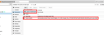

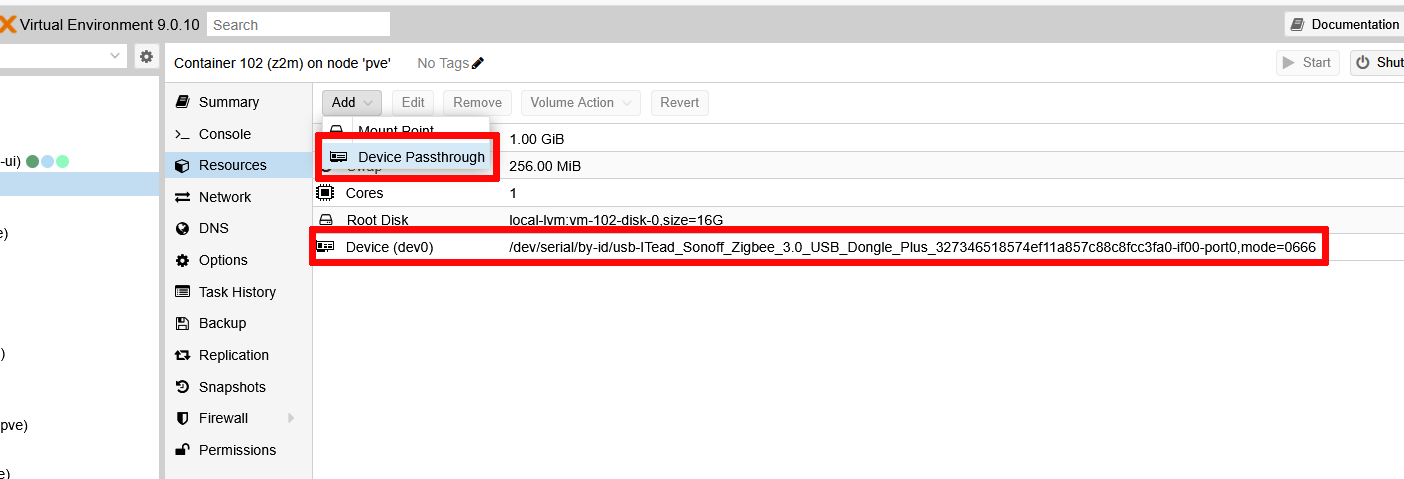

I run proxmox but don’t have a lot of experience with LXC. My understanding is hardware passthrough is a pain for LXC so I’ve not tried OH in one. There may be other gotchas to using openHABian.
Since PVE version 8.2 you are able to perform a Device Passthrough through the UI, so it is a lot easier now.

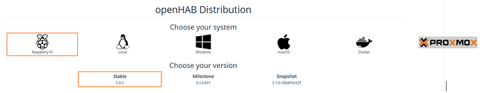

Another option would be to add Proxmox like Docker on the Openhab Download side:
Unless the Proxmox script is transferred to the openHAB GitHub org and maintained there that won’t happen. And that also won’t change the need for the script to adapt somehow.
